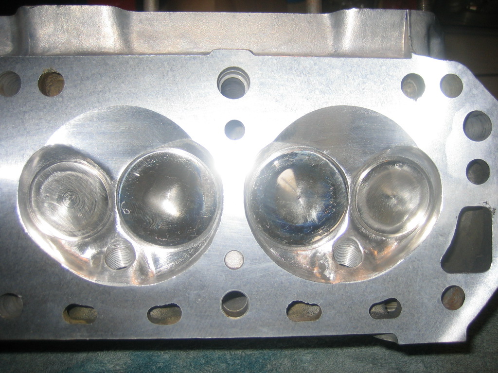

I'm in the market for a big valve head and cam to play with. I'd like to try my hand at some minor porting and polishing. If you know where I can find a solid one for a good price let me know!
Look around, they are out there. Unfortunetly, your late e-88 head isn't one of the better heads ------without major work. I think that is amplified by the fact of that big flowing rebello bottom end.
Hybridz has a great thread on just Z heads.
I did my own polish and port and unshrouding which would help your e-88 greatly
