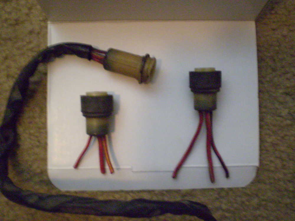

So I'm a little confused. I thought that Dave's headlight upgrade was only available for the 240Z. However both rcb280Z and Powderkeg both used this for their 280Z's. I have a late model 260 that I believe has the same wiring as the early 280's and so if this upgrade can be used on the 280 it should also work on my car.
How do you go about getting Dave's upgrade for the 280Z?
Mike.
The 2) 280Z owners above found spare headlight connectors of another 280Z (the white, round, 3-wire style) or had me make a Hard-wire version for them to wire into the car, after cutting off their connectors.
If you have a spare set of those, send them and $125 and I'll make you a plug in harness.
Pictured below are the 280Z plugs that I would need (on the left) or the 260Z plugs (on the right)
PM me for more info.
Dave
