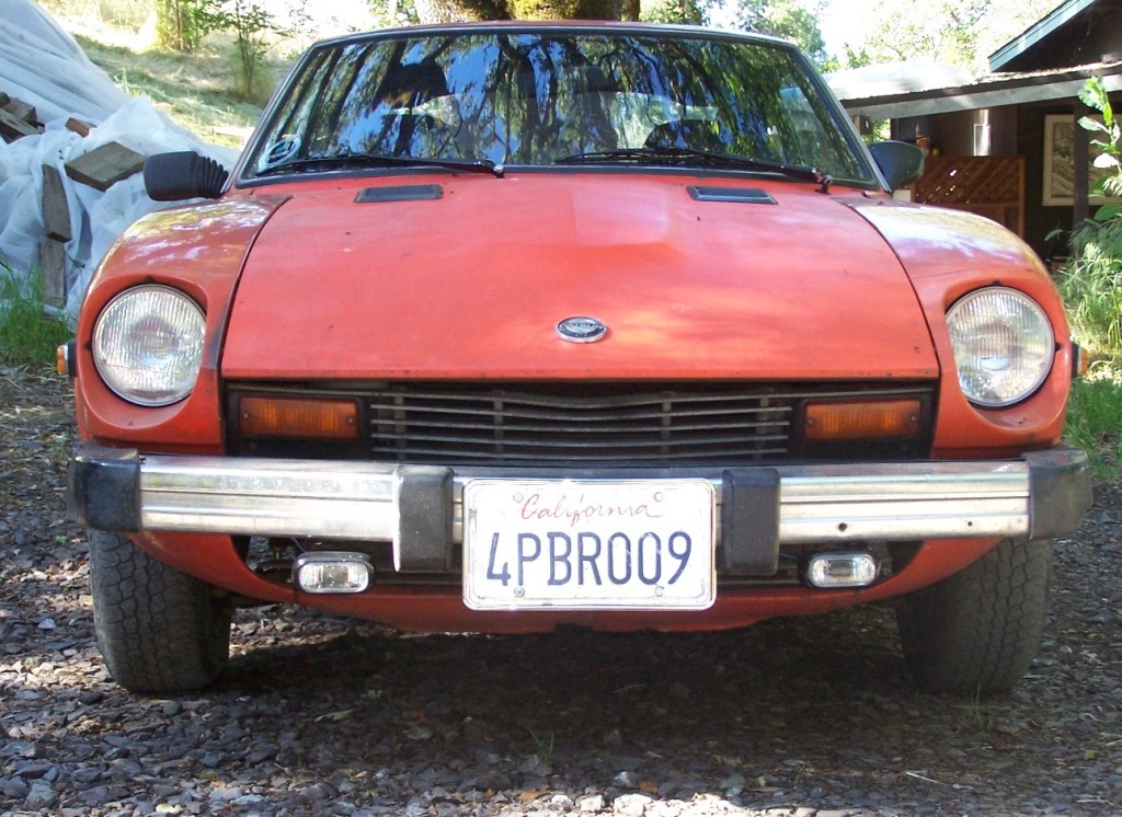

Jan,

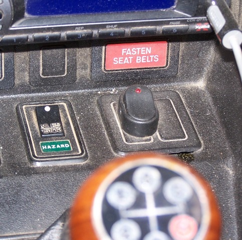

I got a set from Summit Racing: Optilux 1450. It came with Fog lights and relays and easy to follow instructions.
I also got an On/off LED switch from Autozone: Pilot Rocker Switch PL_SW22B.
I relocated the License plate to the center and placed the lights under the bumper on my 76 280Z.post-8478-1415081450751_thumb.jpg

Thanks guys,
Dave, I would like to see a picture of that Z of yours, sounds like it might be interesting. Here's the only problem. I no longer have the original bumper on my Z, as well they weighted a ton and I got rid of em. I searched around today and found this does anyone know what lights those are as that's the bumper I have.
