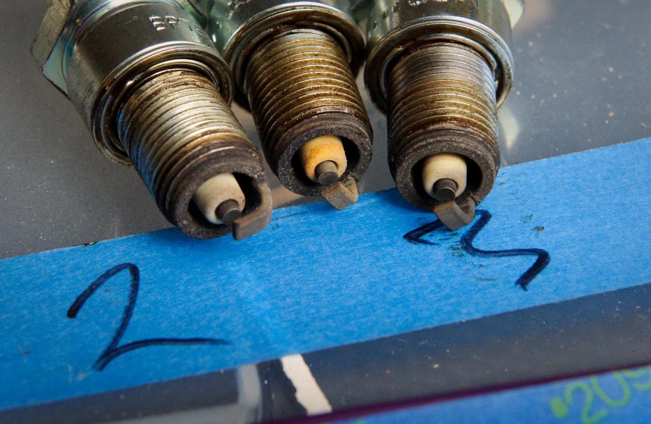

I have been smelling a slight coolant odour when coming off the highway lately. Not much but it happens every time I go from 70 MPH to a stop. I stuck my nose everywhere I can think of that would leak and I can't find any thing external so I am worried about the head gasket. I did a compression check and got 180-185 for all. Plugs look consistent except for #3 which is a little yellow (middle in the following photo).
I am not burning any oil or coolant and I don't see any water in the oil or oil in the water.

I find it hard to believe that head gaskets fail on N/A motors after seeing the punishment they take in my L28ET. I would first investigate traditional leakage points, as in the heater hoses/core, radiator, water pump weeping, which is often dried up by the time you open the hood. Look for "slug trails" of where coolant may have dripped and dried. Carefully monitor coolant level in the overflow, and if your radiator cap is old, go get a new one.
Edited by cygnusx1
I had a similar situation and found that my head gasket was leaking at the very back of the head. You could see the coolant residue right above the starter and a water trail down the block. No leakage in to or out of the cylinders though, just some steam and syrup smell from the back.
I fixed it with some Barr's leak stopper (don't hate, my car is a rolling experiment in how things work, a reason to go to the auto parts store or roam the junk yard. Every "problem" is a new adventure). After about half of the bottle of sealant powder extruded itself out of the gap [a couple of months], leaving a pile sitting on the block at the back of the head, it sealed up.
