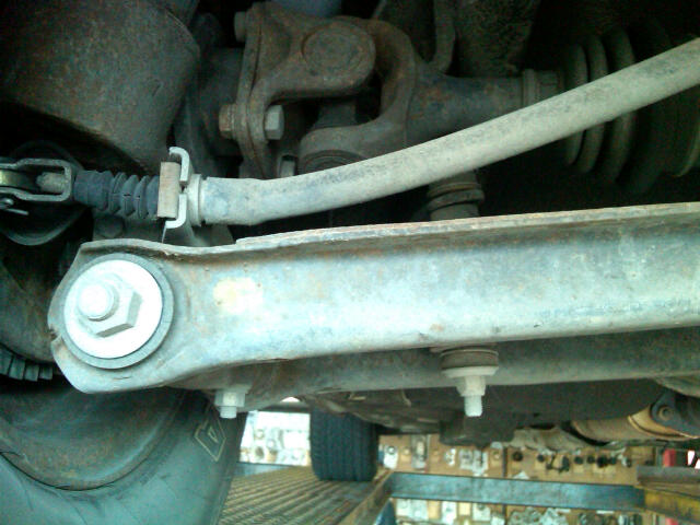

Well, I went to Ripley's Muffler & Brake today to take some preliminary pictures of my chassis before tear down begins. I bought a spindle pin puller for $40, I think I am set to go. I plan on coming to my first Houston Z Club meeting on Tuesday, and by that point the car will probably be on cinder blocks.
Here is a rundown on what is going on...
Energy Suspension Black Poly bushing kit.
4 new KYB struts
4 Eibach Springs
Media blast all suspension components and paint with Rust Oleum Flat Black Oil Based paint. Mix in some semi gloss at about 4 to 1 flat to semi to give the chassis a little more sheen.
Here goes nothin'!

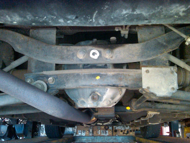

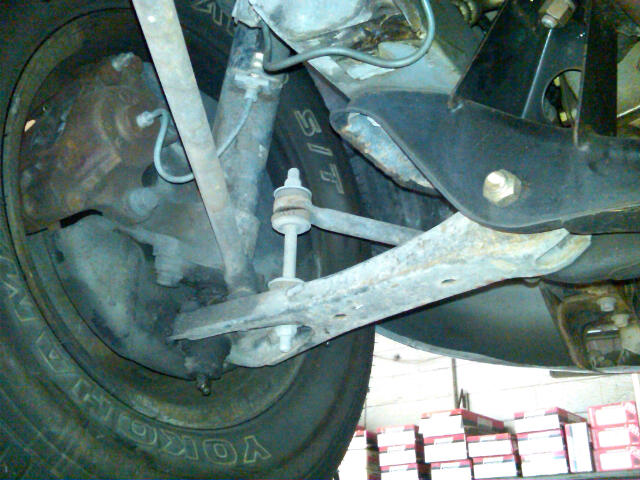

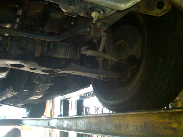

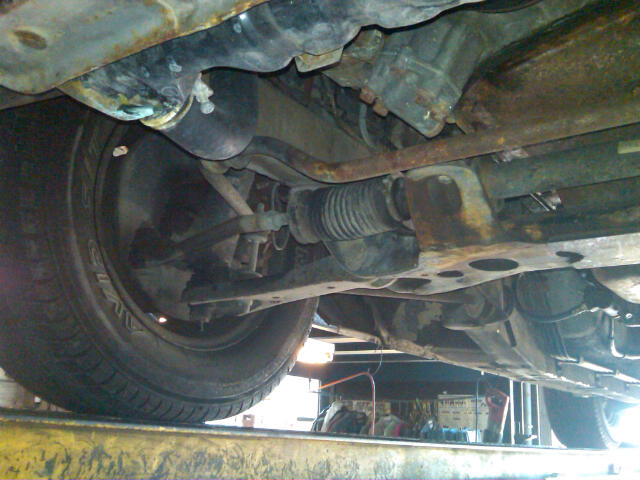

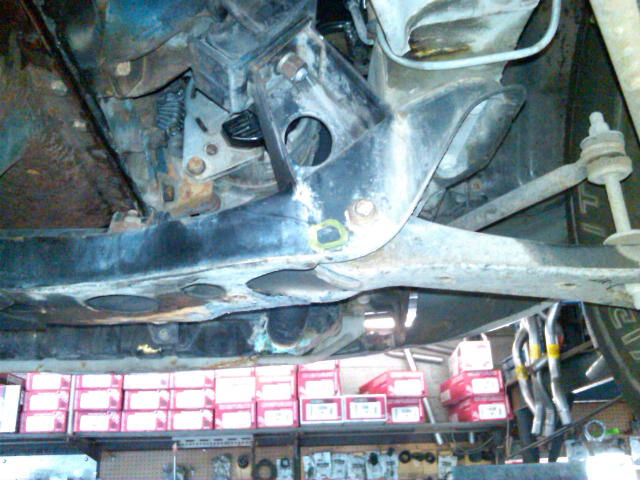

I see some strange stuff in your pics, BTW. Picture 6 and 7 show some metal plates that aren't stock.
I would go for Tokico (HP or Illumina) inserts. I installed HPs and the ride is great. Some KYB inserts were in there before the rebuild and they were too soft for my liking.
I've got the HP's as well and like them.
I don't see anything in pic 6 or 7 that isn't stock ?
I've never seen the plates under the differential in pic 6 nor the plate covering the LCA bolt in pic 7.
The plate under the differential is a damper, and a good spot to jack the car up. It is stock on a 280z. The other plate in pic 7, is actually a rubber flap, backed by a sheet metal bracket. it is stock as well, not sure the original purpose but it's fabricated like a splash guard or something.
