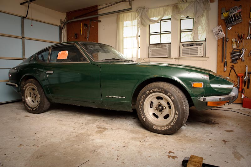

I've been looking for a platform to build into a track/street car for the past few months and I finally found one.
It's a 1971 2 owner 240Z. Very solid body, zero rust as far as I can tell so far. It's been resprayed but I don't think it's had any accident damage. The engine has not run since 1989 so it's going to take some work to get her back on the road. I put ATF in the cylinders and was able to move the crank a few degrees by hand so I think it's not seized. I pulled the valve cover and everything looks very good.

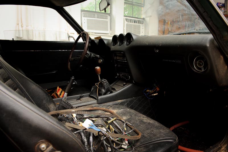

It does have lots of original parts including a new stock wiring harness, heater hoses, dizzy cap, etc. that have never been installed. Not sure why the previous owner bought an extra wiring harness but I'm sure I'll find out soon.

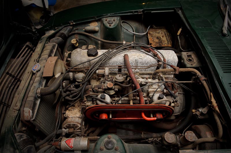

Just got finished stripping most of the engine bay. Nothing left but a short block supported by a jack stand. No surprises yet. Everything came apart very easily. The back of the intake and exhaust valves look fairly clean and the radiator was full of very clean looking antifreeze. Very happy!
The only real issue that I came across was that the throttle shafts on the SU's seem to have quite a bit of play. At least more than I'm used to. I assume they are going to leak given that they have 110 000 miles on them. I could rebuild them but then I would have a rebuilt set of carbs with a vacuum leak. I'm thinking of moving my Z Therapy SU's from my other car (3.0 liter Rebello) and getting a set of triples for it. I've always wanted a set of triples to play with and the SU's should support the 2.4 liter quite nicely.
