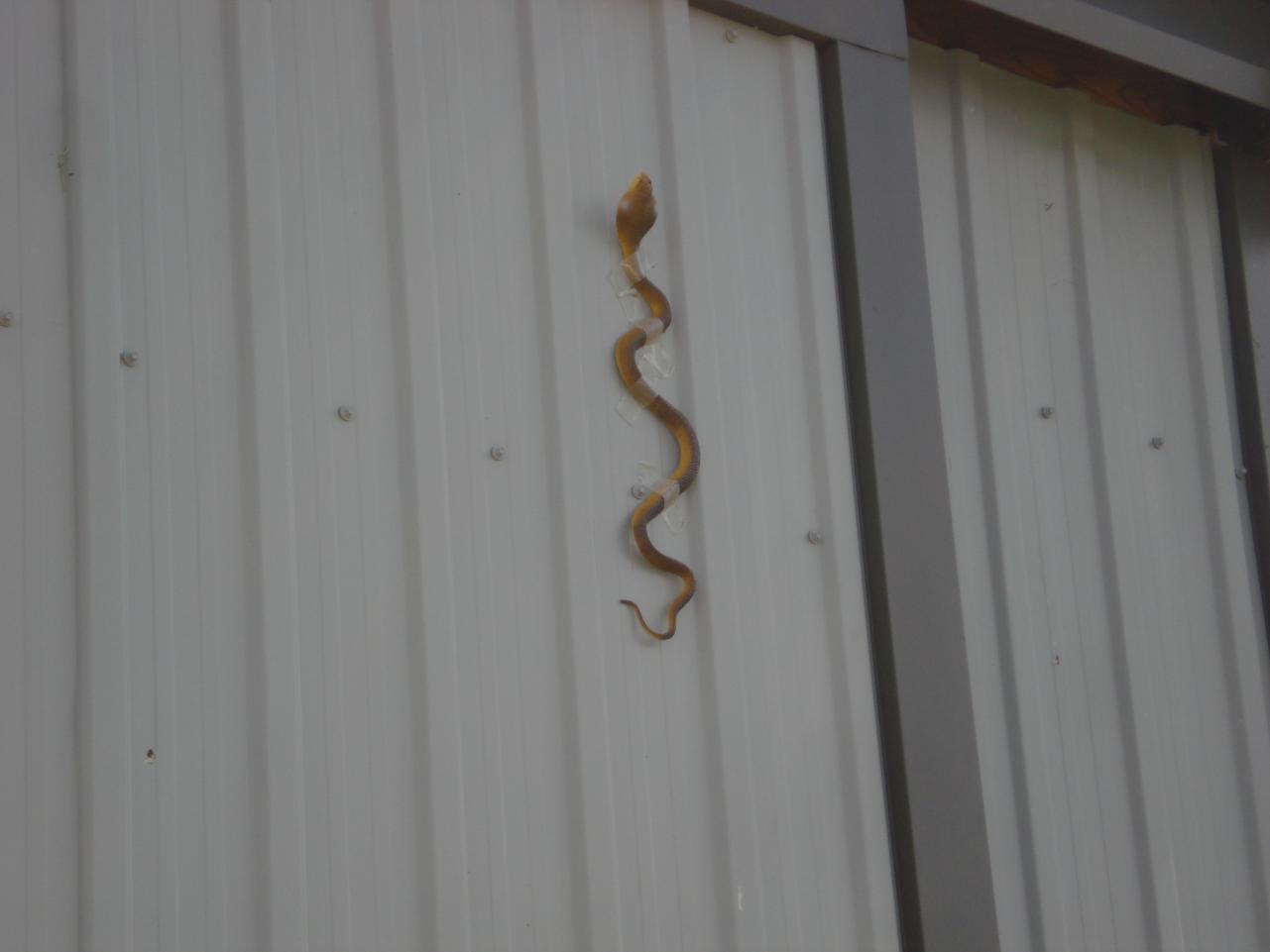

ok here's what i already tried
plastic snake- worked for about a week

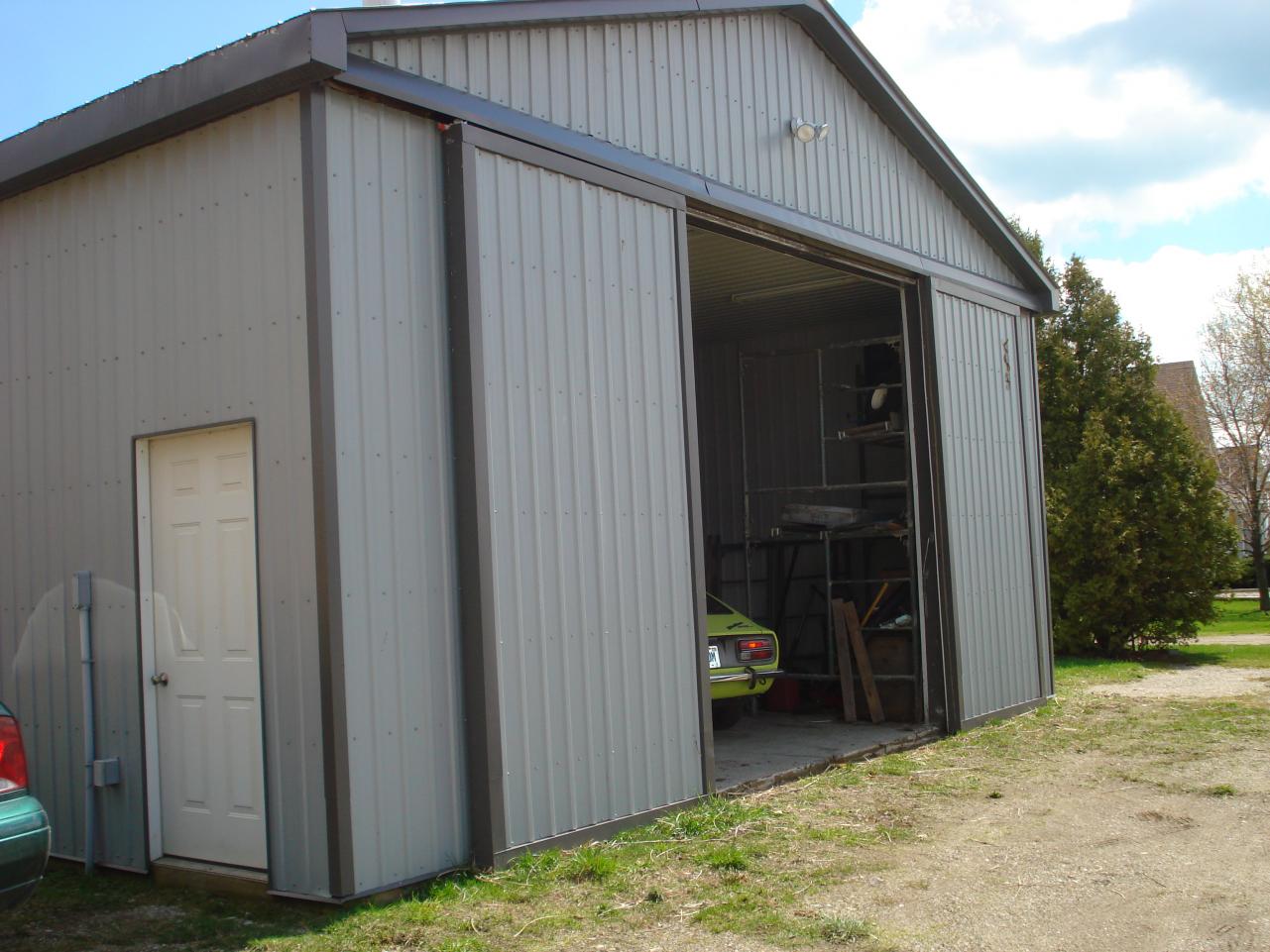

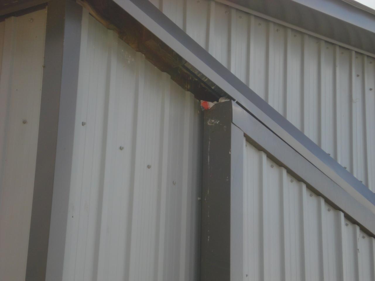

From the second picture, I presume that the birds are nesting in the space between the "V" for the rollers and the top of the door OR they are actually getting INSIDE the "V" for the roller wheels. If so, have you thought of using those nylon bristle brushes like they use on over-the-road trailers... the 18 wheeler ones.
Those nylon brushes can be cut such that they just overlap the "V" in the center and still allow the support rod going to the roller carriage to travel between them. Another small piece can be mounted at the leading and trailing edges of the top of the door to close off that space. Between the two, they would create a barrier to the birds being able to enter easily, and should deter them completely.
