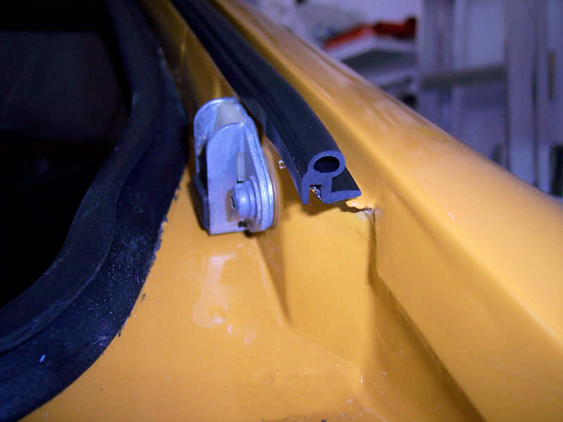

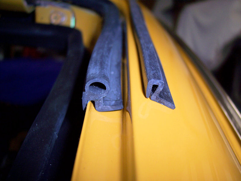

I recently ordered the hatch outer upper and side w/s pieces from MSA. After getting the upper piece installed I moved to the side pieces. That is when I noticed they did not have the same tubular cross-section as the upper piece. I checked and could see there was no way the flat side piece was going to contact the hatch flange, there would be no effective seal.
I contacted MSA with my concern, they assured me these were the correct side pieces and had been shaped like this for some time. I gave it some thought and went back to MSA with a request to RA the side pieces saying I would order two additional upper pieces and fab my own side units. The RA was quickly approved and we swapped parts. The two new uppers were a net increase of $6.
Here are a couple of shots, one showing the comparison of the "official" upper and side piece profiles, the second is my newly installed "unofficial" side piece that provides full contact all the way down.
Jim

Jim the pieces you originally received are correct for an OEM replacement set. That IS the profile of the side pieces, yes, without the bulb.
Many have opted to do as you have and replaced the side pieces with one continuous piece of weatherstripping of the center and upper section variety.
It does seal better and does keep the moisture out of the hatch, however, it will drive those who abhor any modifications to the original design kind of batty... be prepared to be shunned over it.
