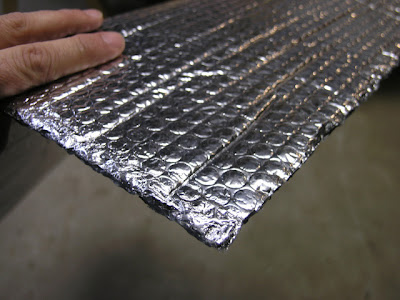

I am installing exactly the same on a resto. For sound insulation I will use either peel and seal (Home Depot roofing section) and/or foil backed bubble wrap (Duct Insulation Wrap).
Here is a sample of peel and seal:
Here is what the duct insulation bubble foil looks like: reflective_insulation.jpg
I cannot speak to the peel-and-stick but be cautious in using bubble foil. It will break down from heat over time and it will crush everywhere you apply any weight.

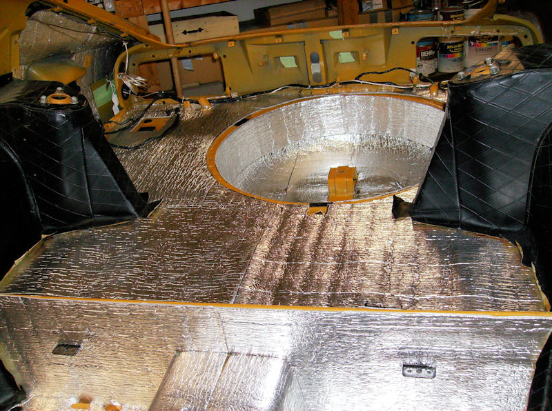

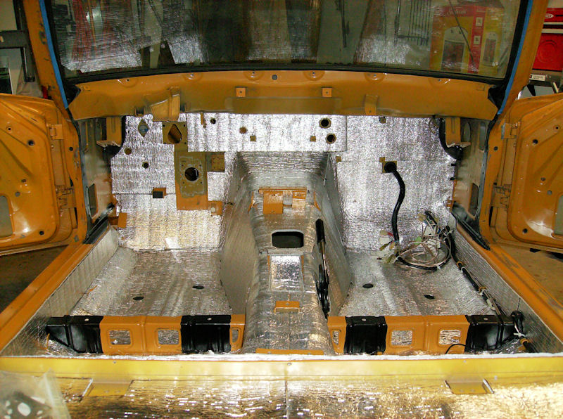

An option I located and used is 1/4" closed-cell polyethelene foil. It will not break down or crush, and it provides a R-factor of 15.7 and noise reduction of 19dBA. The product name is Prodex, I bought it from this site:
http://www.insulation4less.com/Default.aspx
Here are a couple of shots of my interior. I used 3M spray adhesive to install it.
Jim
WOW!!!!!!!!!!!!!!!!! Hey this is amazing. I wish I knew about it a few months ago. I am going to show my guy your pctures and see if we can at least do the floors, underneath the seats and behind the seats and trunk. Great stuff, looks good. Believe me, I am impressed.
