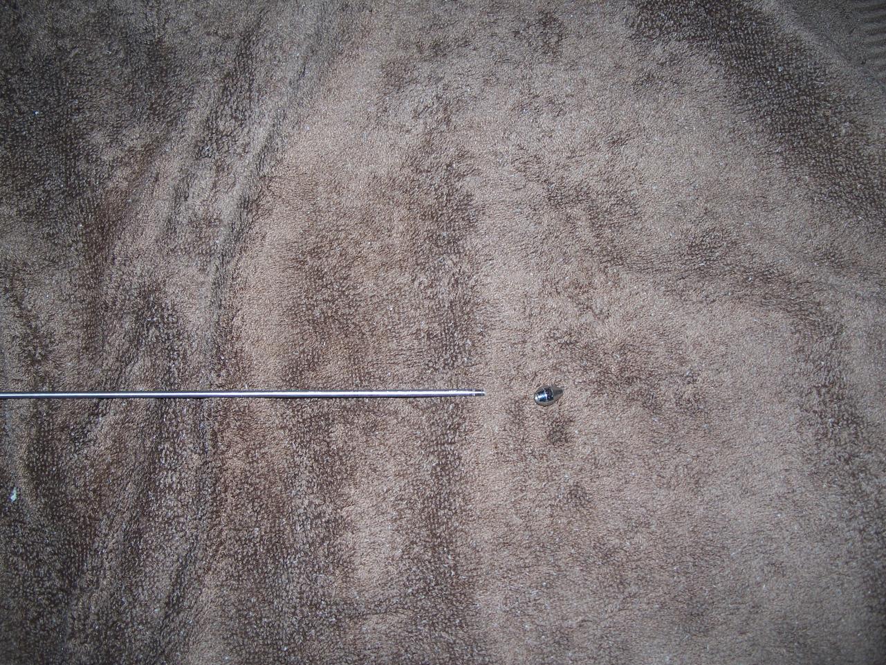

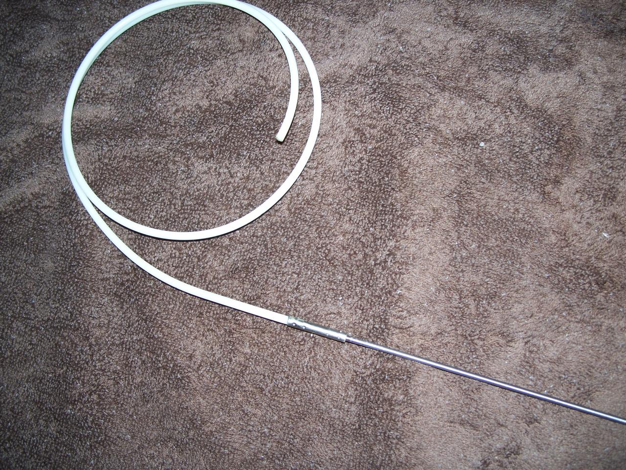

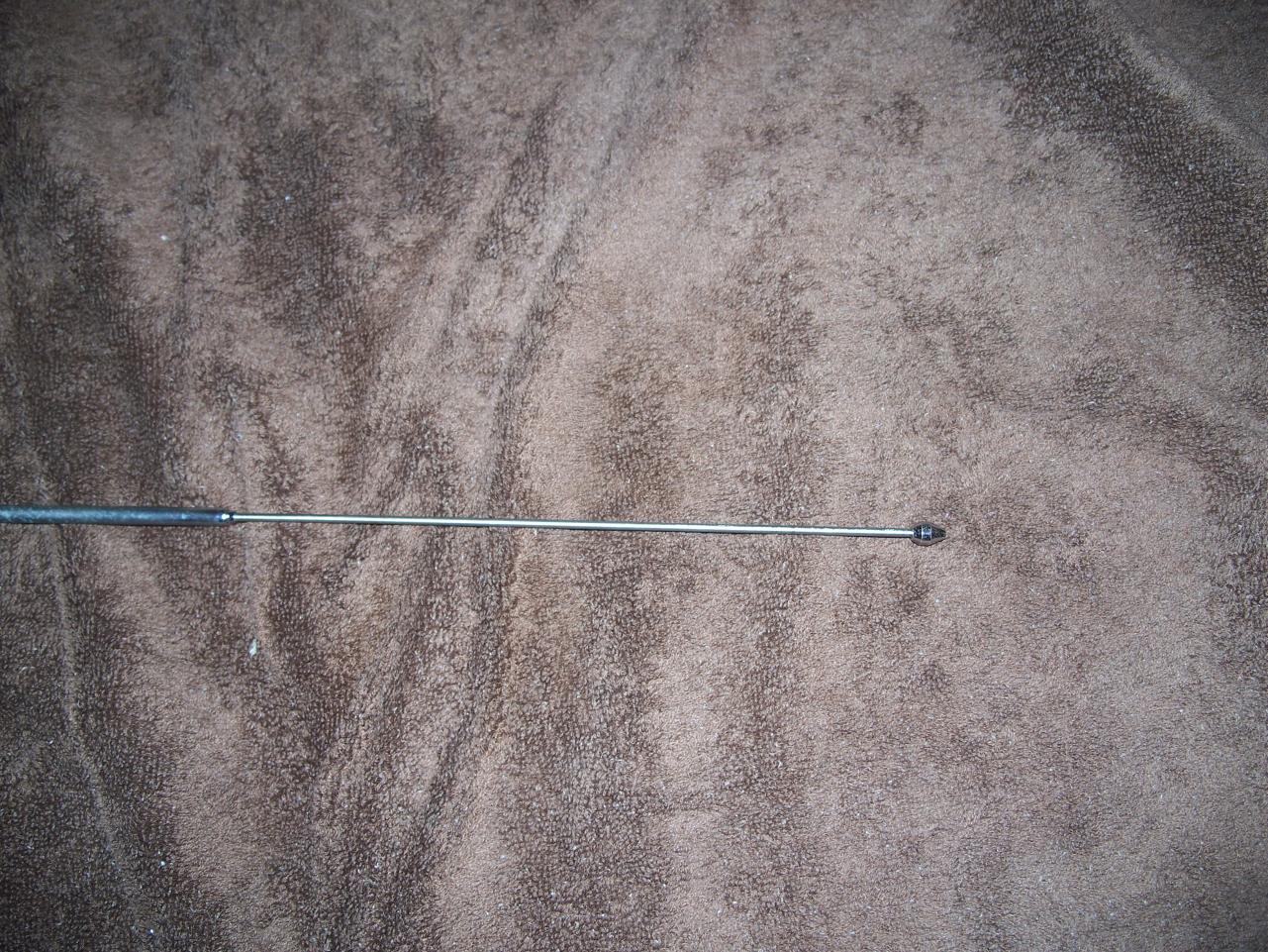

Detaching the spring from the spool is the easy part the hard part is detaching the mast from the plastic string. I got brave just now and grabbed to rags and two vice grips and see if the tip of the antenna mast would twist off, and it did. It is threaded on after the tip came off it slid right out, now I know what I have to work with. I took pictures.
They stamped it on with 8 small points. I was thinking using heat and burn off all the plastic. Then soften the plastic to insert the new plastic string. What are your all thoughts?
I believe with today’s new glues that you might be able to just glue it in place. If not I think I would try removing the old string rounding out the interior, glue the new string in place then drill a small hole through the shaft and string, glue a small rod through the hole and then when the glue dries file off the rod even with the outside diameter of the shaft. That would definitely hold over time and use. jlp
Yeah, if it will burn out, burn it out. Then you'll have 8 dimples inside. Roughen up the end of the new string with very coarse sandpaper. Then put some gorilla glue in the hole, dampen the end of the string, insert, and let cure. Then trim the excess. That gorilla glue (dense polyurethane foam) is incredibly tough stuff. Another great adhesive is 5200 adhesive/caulk -- the regular stuff, not the fast cure. It's another polyrethane product. Give it about a week to cure.
