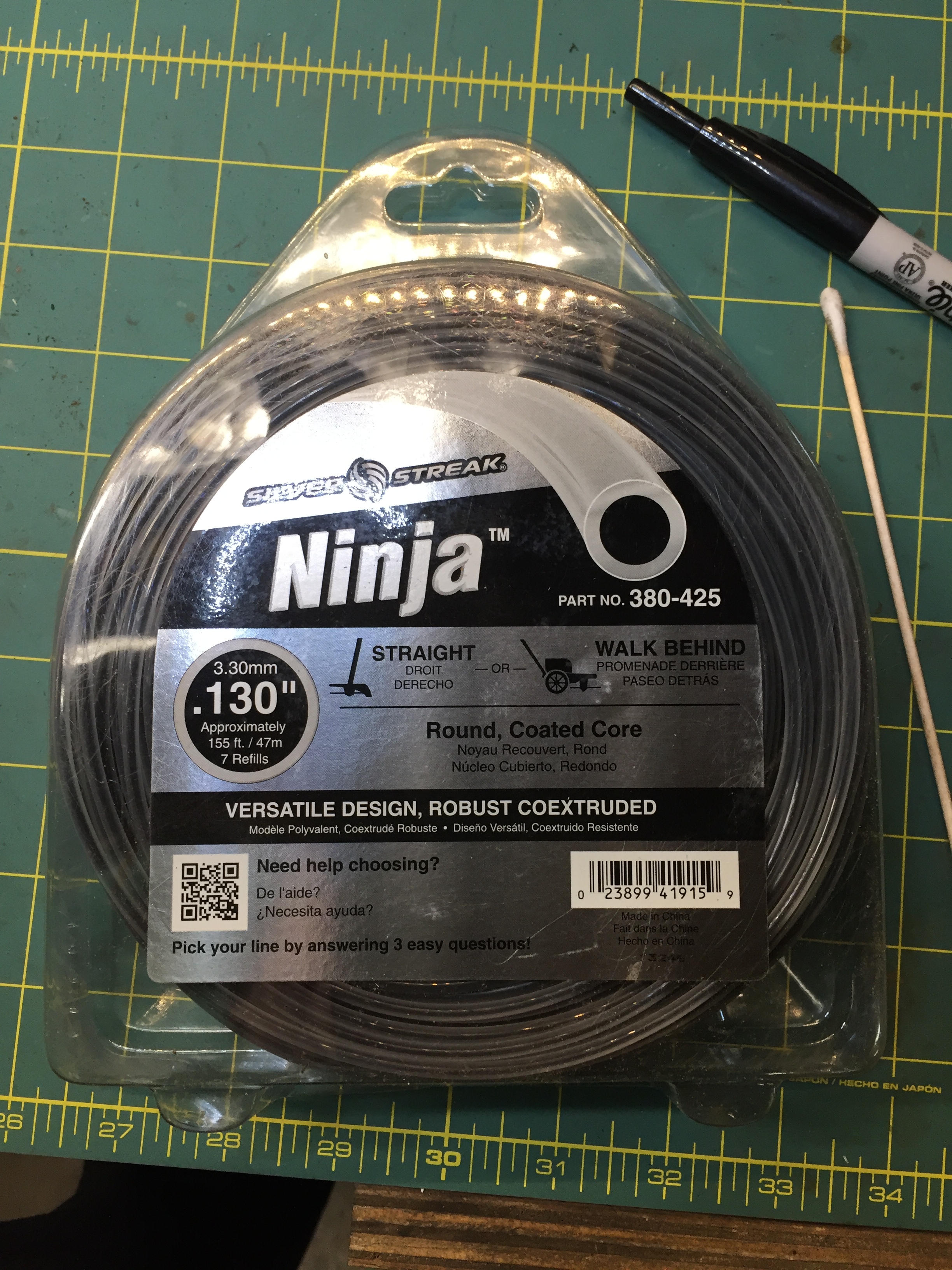

Well I just want to thank all that came before me in the antenna mast plastic pusher piece part thingy department. After receiving my 155 ft of 0.13 string, the repair took less than 60 minutes given what was previously divulged above.
Now I'm the one with 151 ft of 0.13 trimmer sting if anyone needs some....
My poor plastic string was busted in two places
