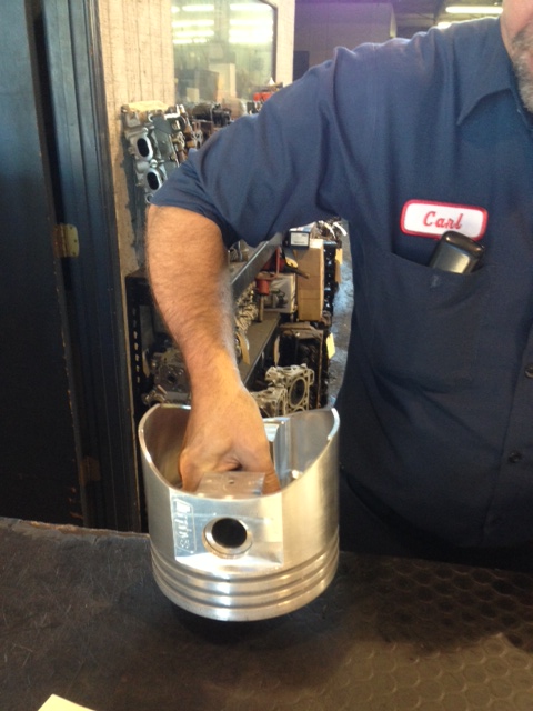

Decided on some bigger pistons....
Won't be able to spin it very fast with those oil cans but just think of the TORQUE. ;) Although there may be some other technical issues...
