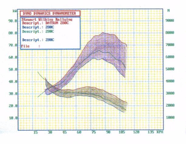

Then I got myself a stock Datsun with an unmodified L28 and thought, "I'm gonna document every change I make to this engine and dyno it every time to see what my butt dyno feels!"
So, I have a dyno sheet that shows the difference what headers and a nice exhaust make to the L series. The original exhaust manifold and 1.75 inch was replaced by a set of HM39 (Aussie brand) and a 2.5 inch exhaust with two mufflers.
I don't want to shoot my own argument down here by saying that the discussion only involves headers and not the rest of the exhaust but I kinda see it as a whole package really. If you didn't want to upgrade the whole pipe and muffler shebang your power gains probably won't be as much as mine. Still worthwhile?.......absolutely. :laugh:
Am I reading that correctly? You really picked up 20 rwkw from the header+exhaust? 60 to 80kw? (80 -107 hp) Is it the 65kw (87hp) line?
