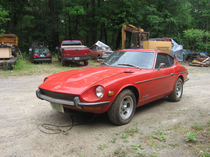

Here is 1971 #20334 back out in the light after twenty years in a barn.
Downsides: Interior mouse damage, paint is shot, rotten tires, no clutch, no brakes, carbs all dried out.
Upside: No rust
Oil level was still up on the stick, didn't see any rust on the cam through the oil filler hole. Pulled the spark plugs and pumped in a 50/50 mixture of WD-40 and ATF, let it sit. She cranks, but that first revolution was a toughie. Had to bump the starter several times to get her moving. Spun over pretty good after that. Bit of pus came out of #1 plug hole, there must have been some crud in that one.
I intend to restore all the original systems, get some miles on her and think about upgrades for next winter.

Now up on stands and more thoroughly inspected. Found a couple sins.
Some crash damage right front. Looks like it maybe hit a curb or over a rock? No upper body damage I can see, seems to have taken it where the strut anchors to the frame along with a good a dent on the frame extension under the passenger floor. Repaired, but things still look mildly tweaked.
Picked at a tender looking spot at the rear end of the rocker/inner fender on the drivers side and found some perforation there. Fine on the passenger side.
It appears structurally sound, as is. Time to get going.
