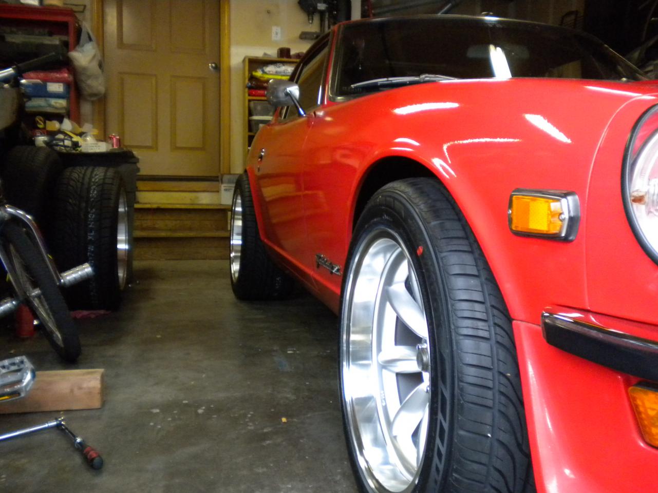

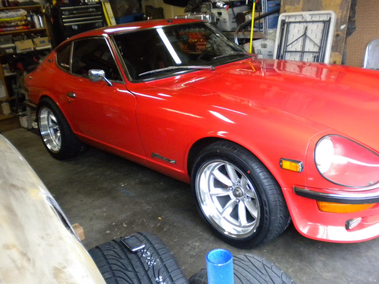

Those tires look like Toyo R888s, if those are Wats, and they are 9 & 9.5, then the offsets are -13 and -19.
Actually, the more I look at the image I don't think they are Watanabes...they don't have a stepped lip.
Edited by DeLorean
I guess he's trying to avoid the fenders. With that kinda inward taper, it'll miss the fender lip but it'll look funny, IMHO.
Dave
well i kinda like the drift/ stretched tyre look. but maybe the stretch will become less.
