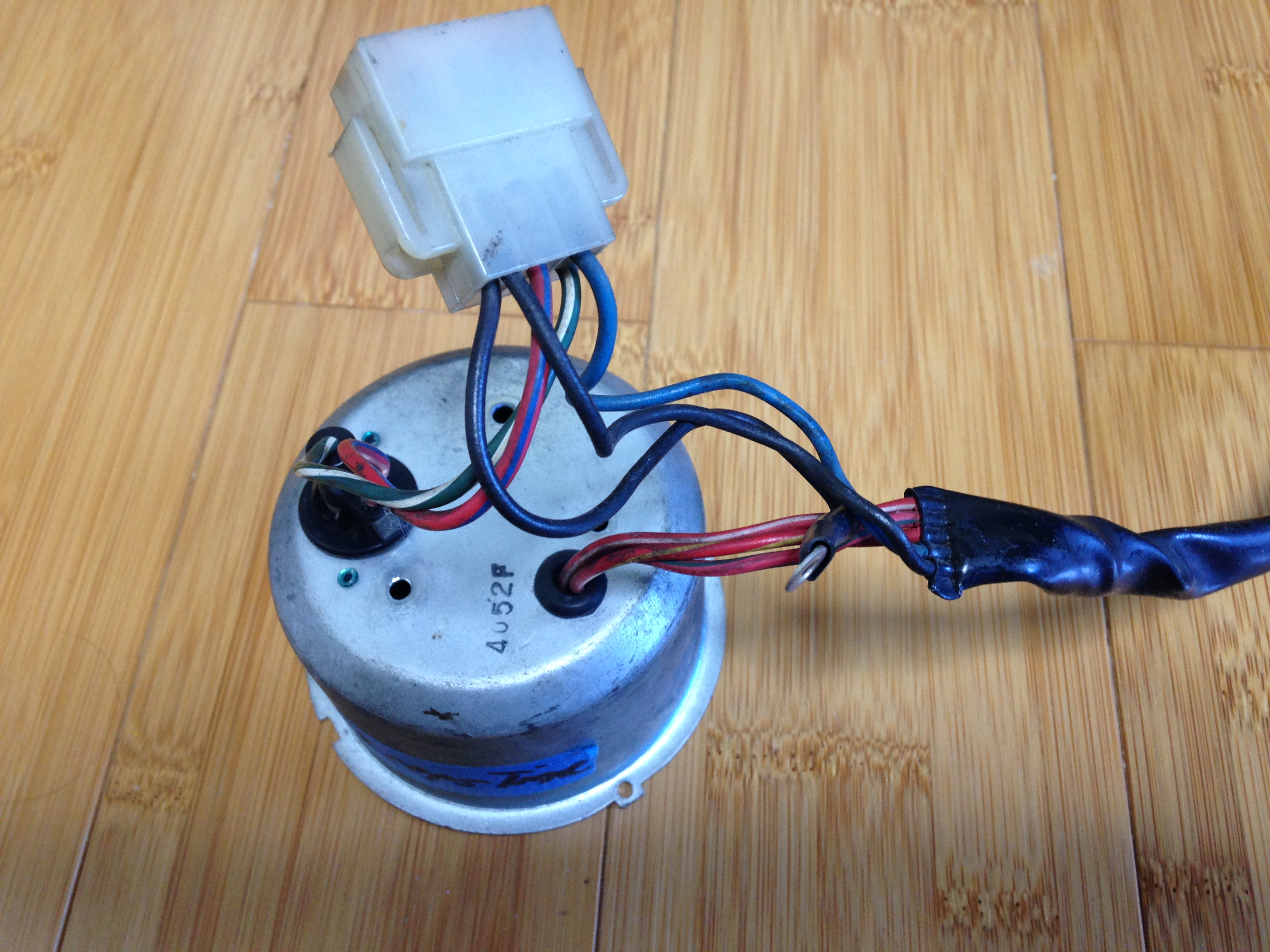

But although the harness I have looks original, a new socket was spliced onto it. I have assumed it was done right, but it’s possible it wasn’t.
It’s interesting to note that both you and I have the White wire going to the Red/Yellow, and the Yellow wire going to the Red/White. It doesn’t matter at all as these two wires are interchangeable.
Where we see things differently is where the black and blue wires from the clock go. The questions marks on your chart suggest you are not 100% sure, and the fact that the harness I have has been spliced means I can’t be 100% sure either.
I think one thing that is certain is that the black on the clock harness is ground, as it connects to the case of the clock. The black wire to the clock and the black wire to the oscillator plug are crimped together at the socket that goes to the car. The other wire from the car is Blue and must be the +12V (or +13.6 as you more accurately have it).
If my wiring harness is spliced correctly, then the Blue from the car (+12V) goes to the Red inside the oscillator, and the Black (GND) goes to the Black inside the oscillator.

This is different to what you have. I’m sticking with this (for now) because it makes no sense to me that they would use Black for 12V and Red for Gnd. The only reason I doubt this is that the Red goes to what looks like a stud on the oscillator case, which would be grounded through the chassis mounts. But if the stud is an insulated bushing passing through the case, then there is no issue (but then why would you not just run the red cable through a hole like the other cables?).

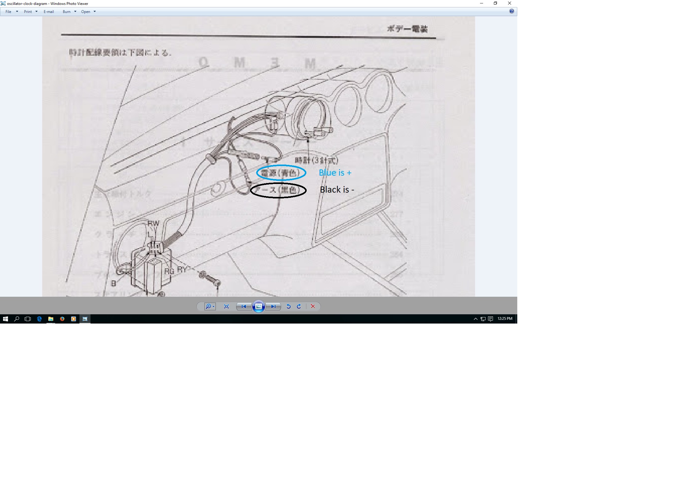

Also, this diagram shows how the oscillator is powered. Blue + and black -

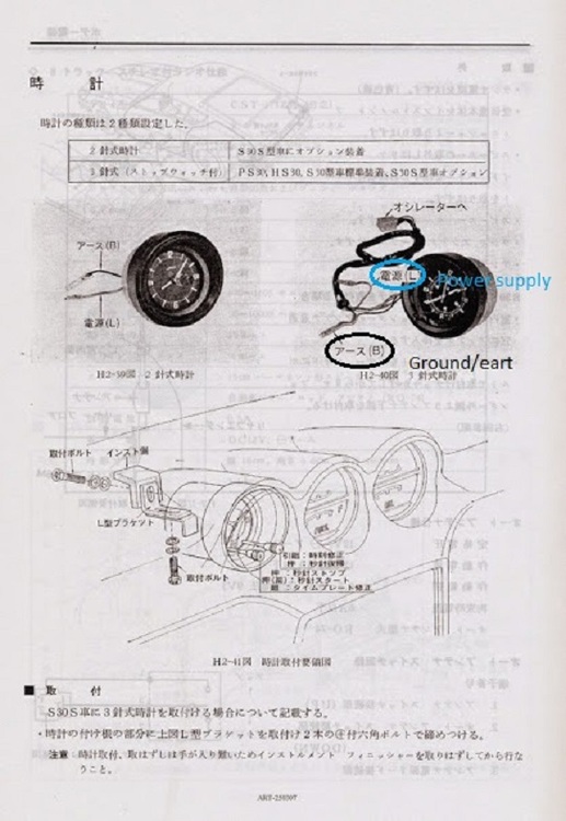

Eric, that's a really bad picture but my wife says she can read the kanji. We went over it a 2nd time. Blue- power supply , black-earth
Here is another photo. It doesn't give wire colors. Just says power supply and ground.  Not sure what the "B" and "L" mean. Any ideas?

Blue = power supply, Black = earth. That sounds good. B and L are just the colour codes.
Greg, If you look at your previous post with your hand-drawn sketch of the plug and wire colours, the drawing from the manual you include in that same post also shows the colours. The letters used in the manual match the letters you uses in your sketch to designate the colours. Only that B is used for Black, and L is used for Blue (as B is already gone).
