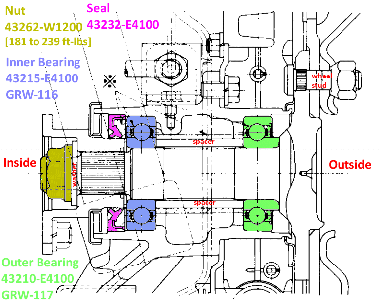

Actually, the outer bearing is not technically a sealed bearing. A sealed bearing is sealed on both sides and comes pre-lubed. Sorry to appear to be a know-it-all. The outer bearing is sealed on one side and still must be filled with greased prior to installation.
