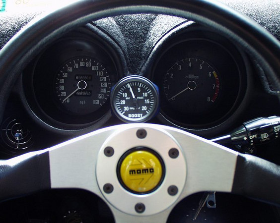

MS can run an AFM. At least I know MSII can. I have it turned off in my tune since I am using the MAP sensor built into the brain box. MS can run better and probably more efficient than the factory system...having said that, you will NEVER be done tweaking the tune, if you are like me. Seems like every little bump or burp I hear, I whip out the laptop and tune some more. It never ends. Sometimes I wish I had the stock system back and just drove it. It can be made to look totally stealthy installed in the car. You could probably use the factory EFI harness for most of the install if you wished to. I mounted my box under the drivers seat but it will mount in the stock location. Heck, it would probably fit into the original ECU case. My boost gauge is double taped on top center of the column clamshell. An AFR gauge could go there nicely as well.
[ATTACH=CONFIG]46752[/ATTACH]
