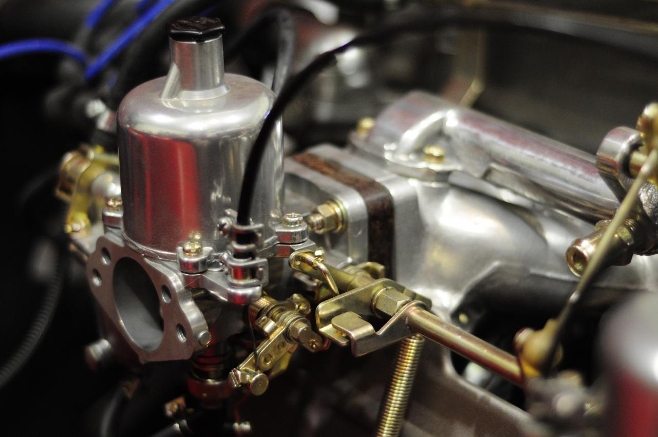

It seems to operate more as an idle speed than a choke, but that might just be a characteristic of these carbs. I've had the car for a few weeks now and only have had an hour or two to tinker with it. The new hazard switch seems to have fixed the signal issue, but I havn't been able to check the brake lights yet, the battery is charging today...

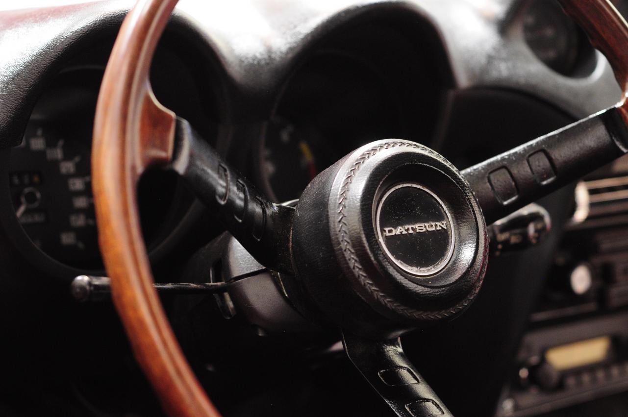

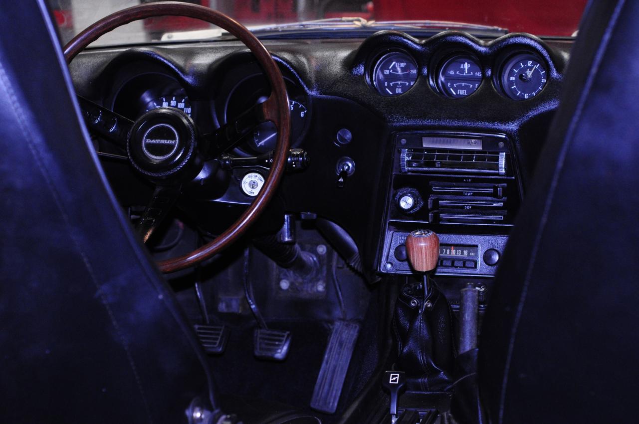

If the lights work after the battery is charged, my next task will need to get the tach and speedo working. The dash has a half-cap, so pulling the tach out might be impossible without removing the entire dash. Any advice or links would be much appreciated. I'll do some studying while I'm in Van.

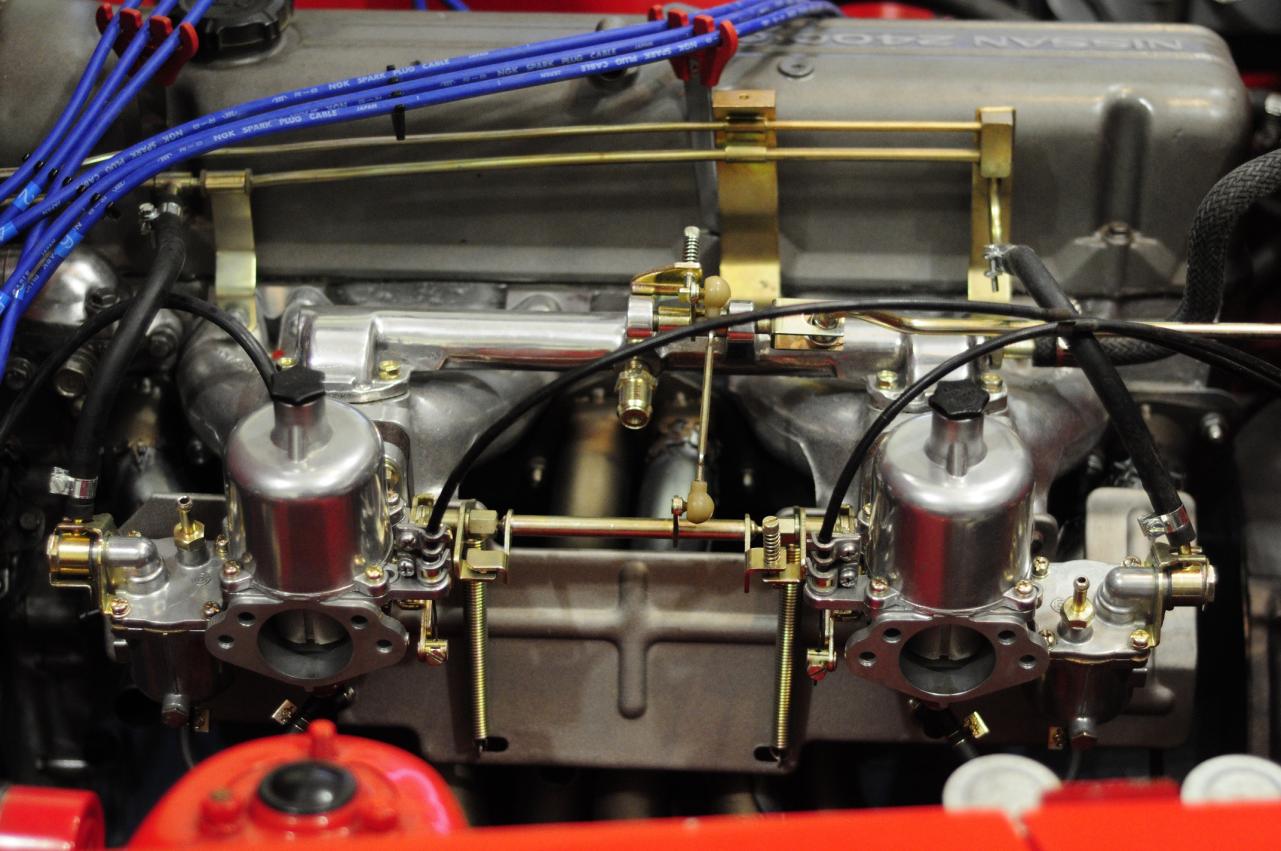

The very early 240Zs had two levers, but they definitely weren't split up by carb. One lever was the start enrichment and the other was an idle speed lever. I think the reason for removing the idle speed lever was because of safety concerns (people using them as cruise control), but that is just what I've read and not necessarily factual.
Mine has the double levers too, and I was told its supposed to operate a throttle type of control. Mine didn't seem to work though, my car is all taken apart now to start to restore it. I'll try and post some pictures right now actually.

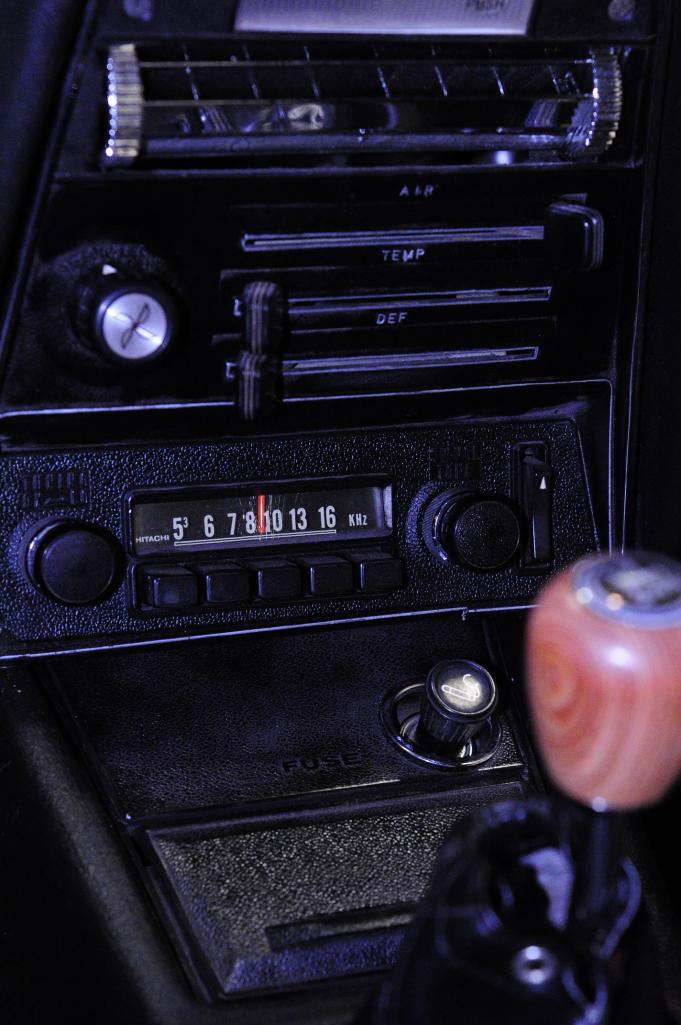

There ~6x4" panel in the console with the choke and what looks to be a rear defrost switch, and maybe some sort of parking light switch, which is broken and msising a substantial piece, also some random wires that have been replaced not too long ago are hanging out. If anyone has one of these panels for sale, or knows of someone who has a spare, please let me know.

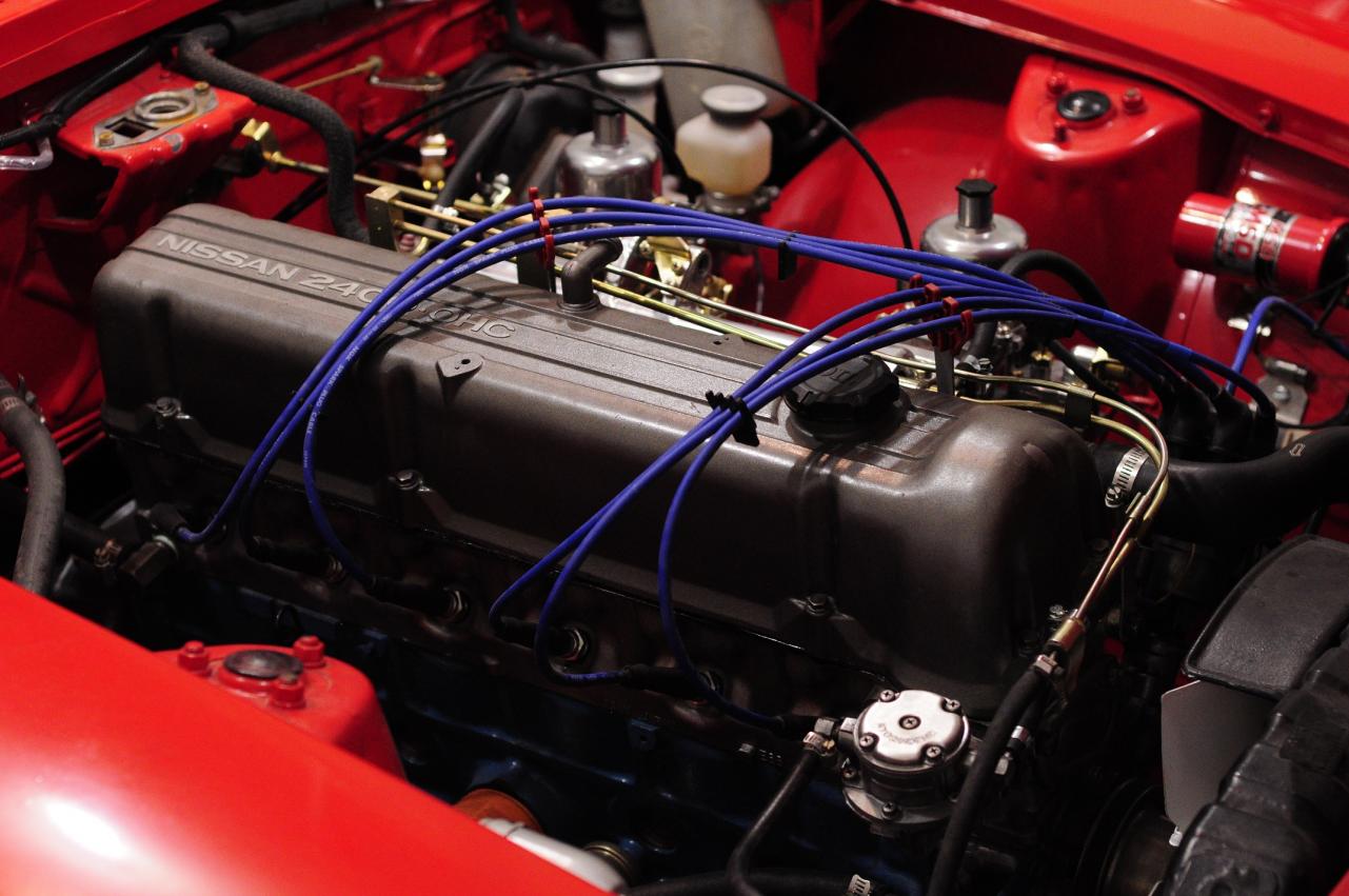

Engine is ready to come out as soon as I find a hoist to borrow. The brand new engine stand is waiting.. Going to need to research what people do with the intake manifold, once SMOG is removed. Looks like brass caps and plugs for the most part. Will probably tap cut and tap the water lines in the carbs too, they're rotted completely apart.

At last, a day to myself to work on the Z! Re-installed HVAC controls, radio, vents, electrical, fuse panel, etc. Got all signals, tail lights, brake lights, headlights, etc, working 100%. Even the map light is fixed! Installed new washer pump and plumbing. Unfortunately the RH nozzle has a crack and is also plugged. It's soaking in CLR, to hopefully clear a blockage. Perhaps I can JB weld the crack until I find a replacement if the blockage is cleared.

I have the same issue as before I sent the carbs to Z-Therapy for an overhaul. I'm also getting the occasional backfire out of the carbs themselves when it's running, so checking timing is probably a good start.
Issue is, car ONLY runs with choke fully closed. Will not idle unless it's 80% closed. I should also change the fuel filter before I start messing with anything. Any other advice or experience with this symptom?
I should mention to the dash-cap haters... It came that way and this dash is the worst I have seen under that cap. I picked up another 70' 240z dash with all gauges intact a couple of weeks ago, and plan to restore that one, which only has one small crack above the clock. Is it bad taste to move the VIN plate from one dash to another? There is about 12,000 VIN difference between the two, but otherwise look identical.
