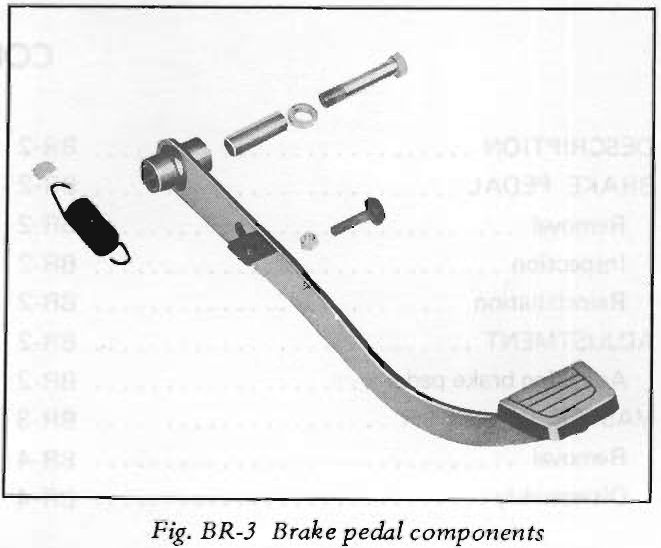

Here is the factory service manual for the '72 brakes.
BR Brake System.pdf
The brake pedal free play is not specified in the factory manual per se. The manual says to set back off the pedal stopper and then set the push rod length to attain a pedal height of 8.11". Next, adjust the pedal stopper to attain a pedal height of 7.99". Also, make sure the brake light switch is not intering with the pedal stop.
