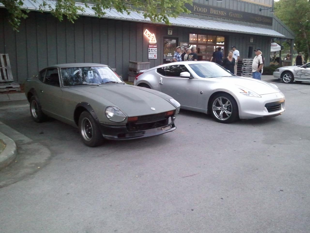

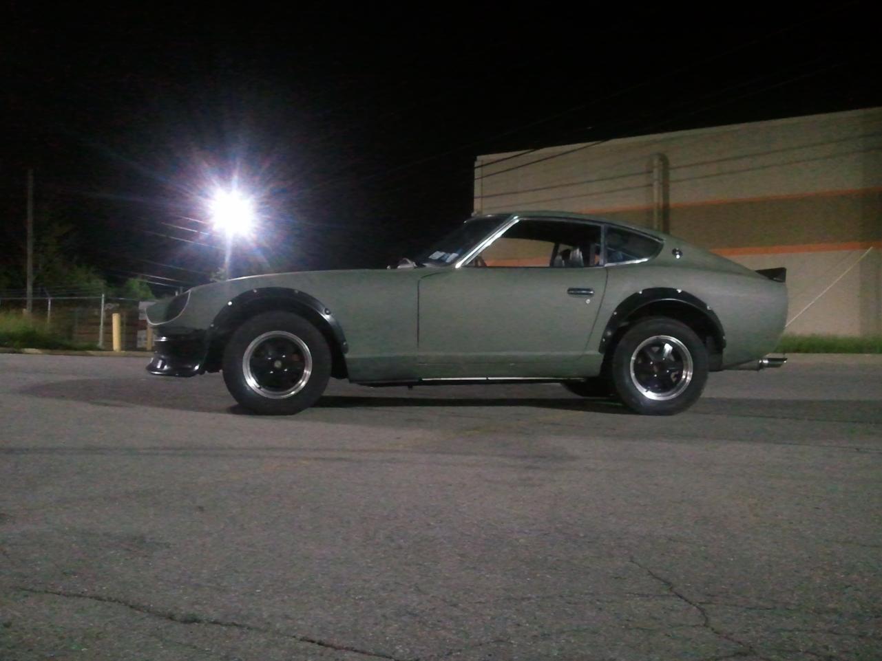

I've attached photos of how the car sits now, it looks lifted... post-22536-14150815766878_thumb.jpg

I'll browse around for someone with 16x10s on the car, as for the fronts should i increase the backspacing to 4.5 or 5 maybe?
