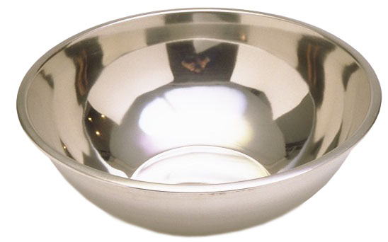

BOWLS
Get at least one big stainless steel salad bowl. You can throw a lot of parts in it and scrub easily with a brush (and suitable non-dissolving gloves).
The bowl allows you to scrub while capturing all of the spatter and it makes it easy to do many parts at once... say a whole disassembled SU.

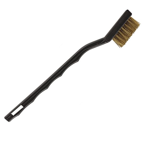

BRUSHES
Brass wire brushes are gentle and work better than plastic (which can melt/dissolve). Get an assortment especially ones on long arms, curved heads, big ones and small ones. You can get nice ones for cleaning guns that come with "T" handles and extensions. You can also use one like in the picture above with a small vice grip or in a drill.
Here is a typically smallish one that works ok. Generally the bristles will deform so buy several.

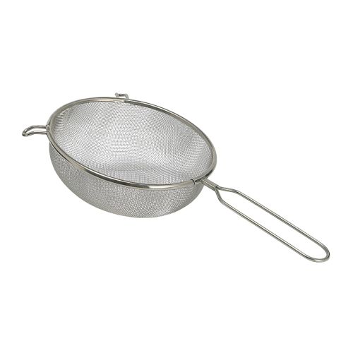

STRAINER
Use a stainless steel strainer for holding parts when you spray them with an aerosol carb or brake cleaner. You can place the strainer in the salad bowl or in the canister so that the over-spray is collected.
The other useful application of the strainer is to capture parts! As alluded to above, if you have a canister filled with carb cleaner and carb parts, it is no fun to retrieve them. That is why at least two containers are needed. You simply place the strainer in the bowl or over the empty canister then pour the canister full of carb cleaner and parts into the strainer. It will collect the parts and let the fluid pass through.
You can also place blue shop towel or similar in the strainer and run used dirty solvent through it to clean the solution.

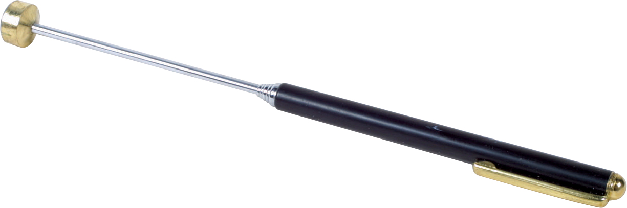

MAGNET
This will pick up most parts that are immersed in solutions except for plastic, aluminum, copper, and brass. You may wish to use tongs or similar to cover all bases.

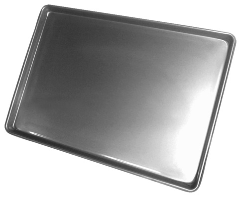

PAN
When you want to catch drippings from a brake bleed or just as a back-up to protect a garage floor, a stainless steel pan is great to have under your work area. I have seen some alloy pans that are ~ 4' X 2' in size.

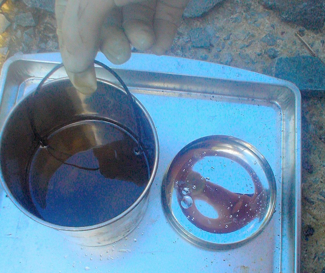

Here is a canister filled with lacquer thinner on a pan with a clutch-fan o-ring being dipped quickly.
