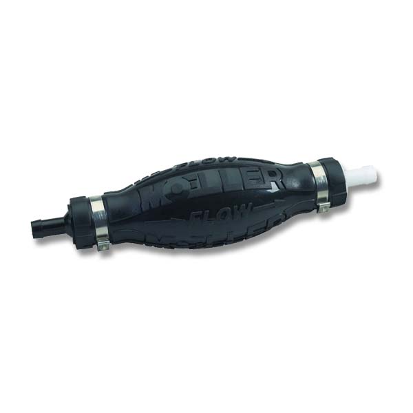

Well I am fond of the clacker as I love mechanical technology but I never liked it when it lost its prime.
I was always thinking that a bulb primer by the tank would have been good addition for emergencies with its one way valve to boot. Hey I guess you now know I used to run outboards in the Canadian back woods LOL.

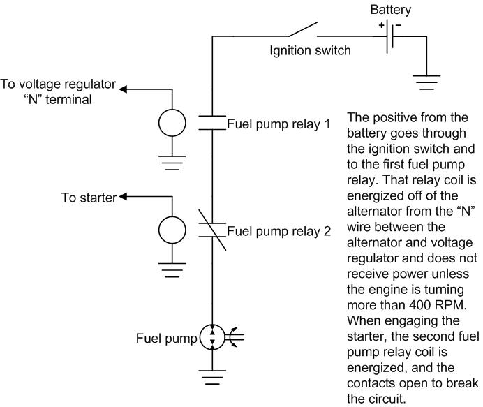

Phil,
While I'm thinking about it, keep in mind that if you put in an internally regulated alternator, this won't work (unless you install a high power diode). A lot of us found this out when we put in internally regulated alternators because the batteries would run down due to the fuel pump relay being constantly energized. I found the connector that was responsible for that and took it out. My battery stopped draining after that.
For anybody who is curious, I recreated the drawing in the FSM since the scanned copy is on the light side.

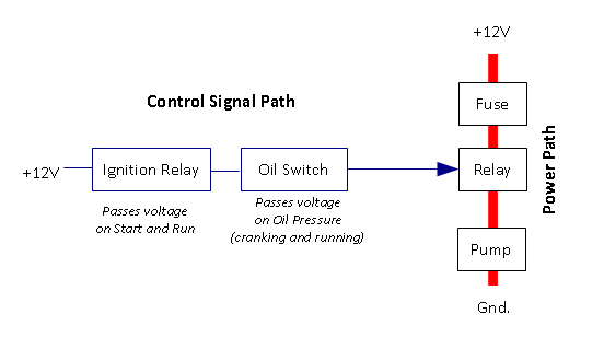

For my current plan:
Control:
The signal to energize the relay would come from the ignition circuitry. When the key is off the energy draw from the battery would be off. As well this control signal would also go through the oil pressure switch so even with the key turned to on and the car not running, the pump would not run. The pump would only run when cranking AND oil pressure OR when running AND oil pressure. It may have a switch in series for theft protection.
Power:
The pump would draw from a separate circuit that is fused and is connected as electrically close to the battery send and return as possible. It would also go through the main contactors in the relay.
