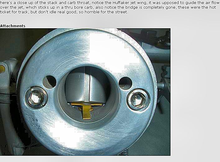

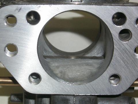

"On HS2s and HS4s for racing we thru-bore them, meaning
no bridge what so ever
, on HS2 you will actually run out of room, meaning a hole in the bottom of the carb you have to epoxy up. However for street cars this would ruin driveabilty, but with race carb nothing but wide open throttle matters. On a street car I would not worry about bridge mods, if I made any mods to a stock carb for the street I would think about beveling the slide so the square leading and trailing edge is nicely radiused towards the opening front and rear. There are a good many books on SU carbs that was mentioned above, also consider getting on chassis dyno with a air/fuel ratio meter, you might be pleasantly surprised with the gains you can make with stock carbs with the proper needles and jet adjustments."

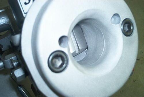

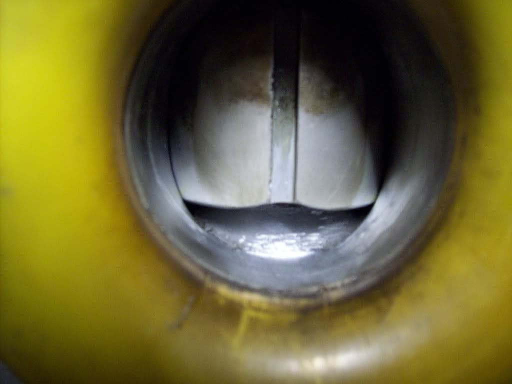

Under SCCA rules for G Production, the Datsun 1600 was required to run a pair of Hitachi carbs. These were very similar to British SUs. In fact the needle valve from one would fit in the other. The SCCA rules allowed substantial modifications to the carbs as long as the bore was not enlarged at the butterfly valve. So over the years we made the following modifications:-

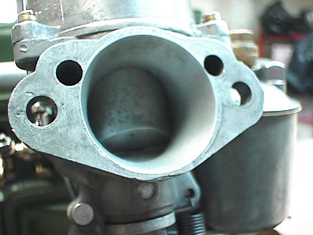

Rounded the front of the piston
Removed the step at the jet
Angled the rear of the jet to help draw fuel mixture
Increased the diameter of the bore to a point just in front of the throttle plate (3/32")
Thinned the throttle shaft and butterflies
Used very light springs on top of the pistons, or no springs at all

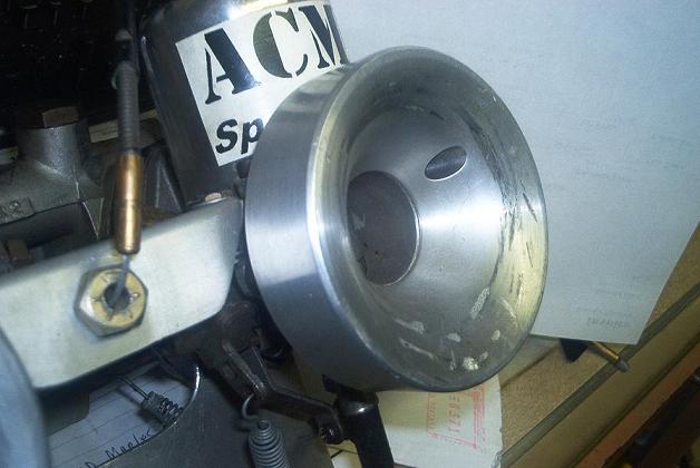

Tuned the intakes with velocity stacks to suit the RPM range of the engine
Set carb float levels slightly higher than stock so no starvation at high RPM. I used brass floats. The most important and difficult part was finding the right needle end jet combination.
My final solution was boring the stock jet larger to .095 and finding a needle that would provide a good fuel air mixture over the rev range I was using. My final solution was to customize the needle on the dyno and at the track by chucking the needle in an electric drill and dressing it down to suit. Not very scientific but it worked.
I also matched the carburetor ports to the intake manifold ports. After some trial and error I found that by leaving the carb ports slightly smaller than the intake manifold that it was as good or better than matching and took less work. (This is the reversion factor). The intake manifold was matched to the head in the same way.
The intake manifold was enlarged to properly match the carburetor and the head ports. The hole in the balance tube was enlarged to 9/16". This smoothed the power out put and improved the idle.
