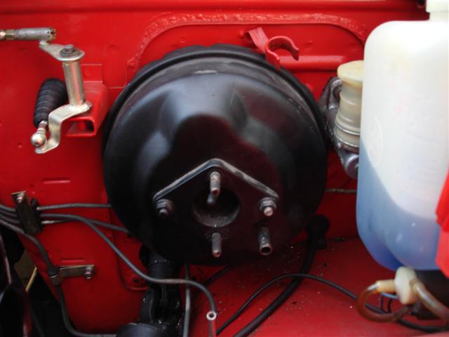

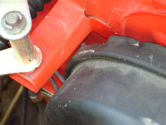

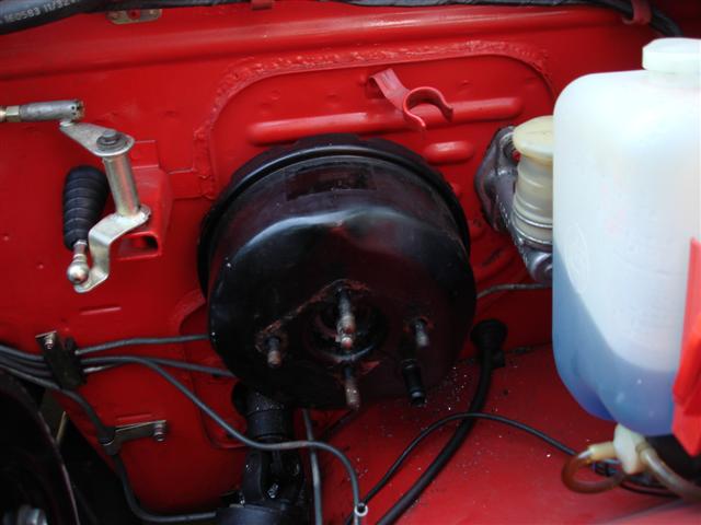

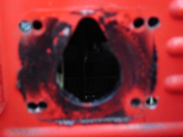

240260280z Posted August 22, 2011 Share #17 Posted August 22, 2011 Yup, Even a 280zx will fit. You may have to drill some holes for the larger ones. Here is a big 280zx on an early 240z Before and After: Drill holes Clearance and Fit of Big 280zx booster. Note the 280z booster is smaller. Link to comment https://www.classiczcars.com/topic/40543-another-brake-booster-question/?page=2#findComment-364593 Share on other sites More sharing options...

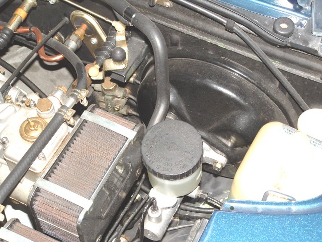

240260280z Posted August 23, 2011 Share #19 Posted August 23, 2011 280zx booster on a 260z Link to comment https://www.classiczcars.com/topic/40543-another-brake-booster-question/?page=2#findComment-364692 Share on other sites More sharing options...
