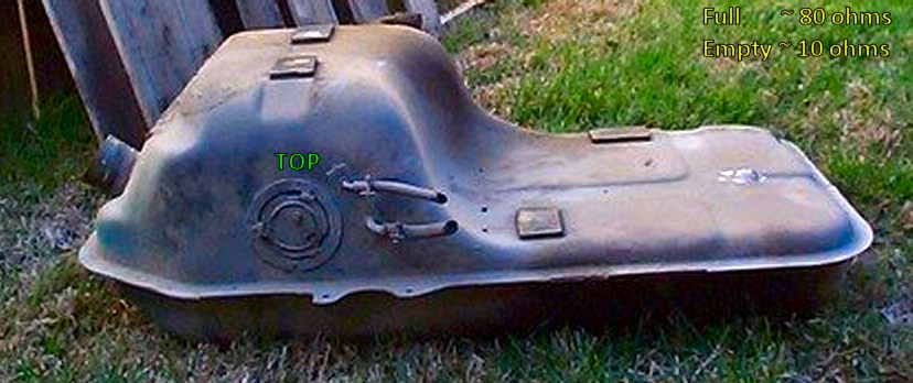

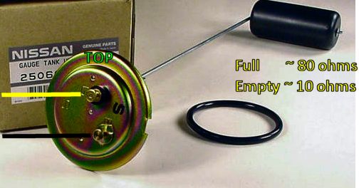

It could be upside down too. I believe the yellow cabled +pos connection (with stand-off) should be on the top at 12 o-clock.
I agree, I drew a diagram of how it came off the tank, the black/yellow wire does go on top. But I will be darned if I noticed how I installed the pick up...I will check.
I will be surprised though. The sending unit has a notch in the side that will only let it go on one way. I may have my wires mixed up then. I will check the resistance going through it tomorrow.
I checked the resistance between the two terminals, and I get a constant reading of 86.7 Ohms with about 7 gallons in it.

BUT I removed the gas sending unit and hooked an OHM meeter to it. It is reading full about 11ish Ohms and 85 Ohms when empty. About. When I put it back in the fuel needle moved up past E and about a 1/3rd up the gauge...which is about 6 to 7 gallons, I am sure these gauges are more accurate in the middle. So now I will fill it up and see if the gauge moves again. I see no reason why taking it out and moving it and installing it again would have fixed anything.
Could have been hung up.
Also there is an adjustment screw on the back of the fuel gauge that (if remember correctly) controls the radial distance between the indicator needle and the bimetal strip for calibration.
