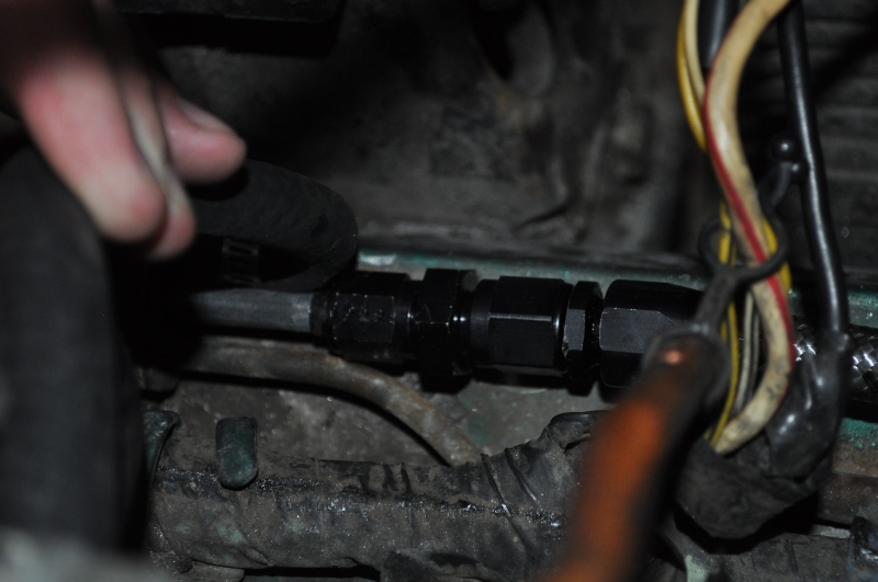

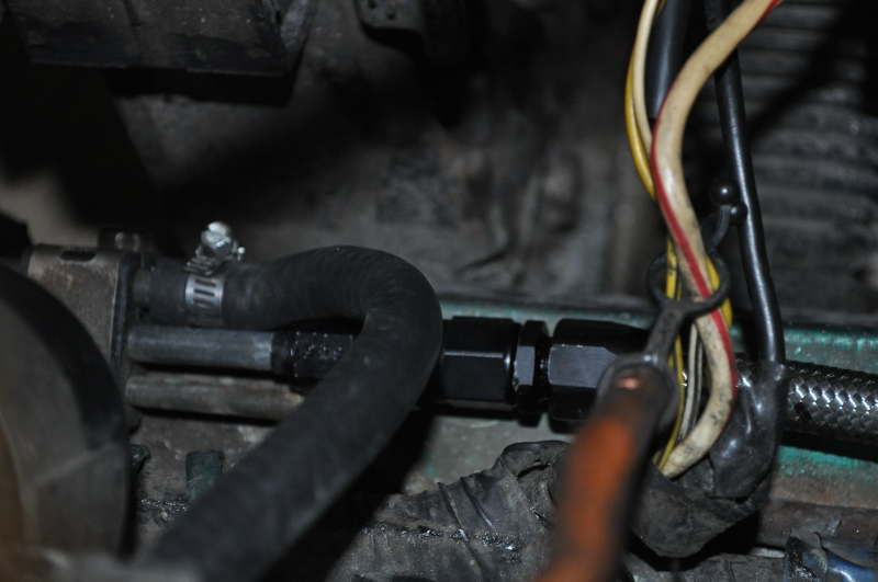

The third challenge was actually the hardest and my son and I spent 3-4 hours getting an AN adapter on the stock OEM line. (I decided not to replace the hard lines all the way back to the tank as my lines were in pretty good shape). Unfortunately I was not 100% sure of the size of the OEM line, but I measured approx 5/16 inch with calipers. I didn't really know if this was a true 5/16 or some close metrric equivalent. I ended up using a "tube nut" and "tube sleeve" from Earls that supported a 5/16 inch hard line and it was a perfect fit. At that point we thought we were out of the woods, only to find that the hard line where we were going to connect had a slight bend in it and the sleeve would not slide over. We ended up having to cut the hard line further back (on top of the frame rail) where we had about 3-4 inches of straight pipe and could get sufficient room to install the nut and sleeve and have room to make the required 37 degree flare. This also proved a little challenging as the space was very tight and the flaring tool barely fit, but we managed to make it work after 3 or 4 tries. We did have to remove the clamp which held the fuel line as well as the 2 OEM return / evaporation lines to get enough room to make the flare but this was relatively straight forward.

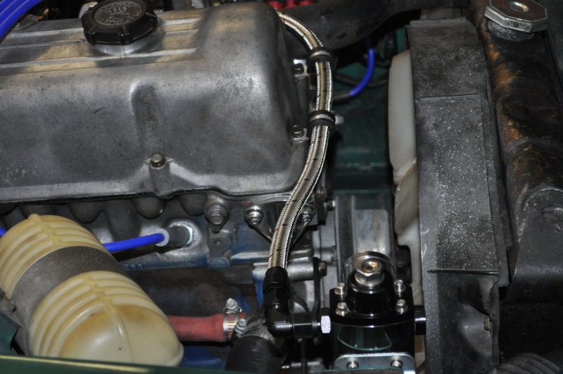

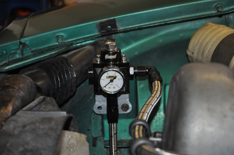

After that was completed, it was pretty much smooth sailing. We ran adapters / lines up to the new fuel regulator which we mounted where the carbon canister had once been installed. This was a perfect spot for it and the holes were already there. My son fabricated a bracket for the fuel log which we mounted on the center mounting studs of the intake manifold. I was a little concerned about heat and vapor lock with this position, but so far no sign of that and I hevan't even installed the heat shield yet.

1. It was really hard to find a fuel regulator that supported the low pressure required by the Webers and had the AN fittings I was looking for. I finally located one on Summit Racing (P/N 220065)

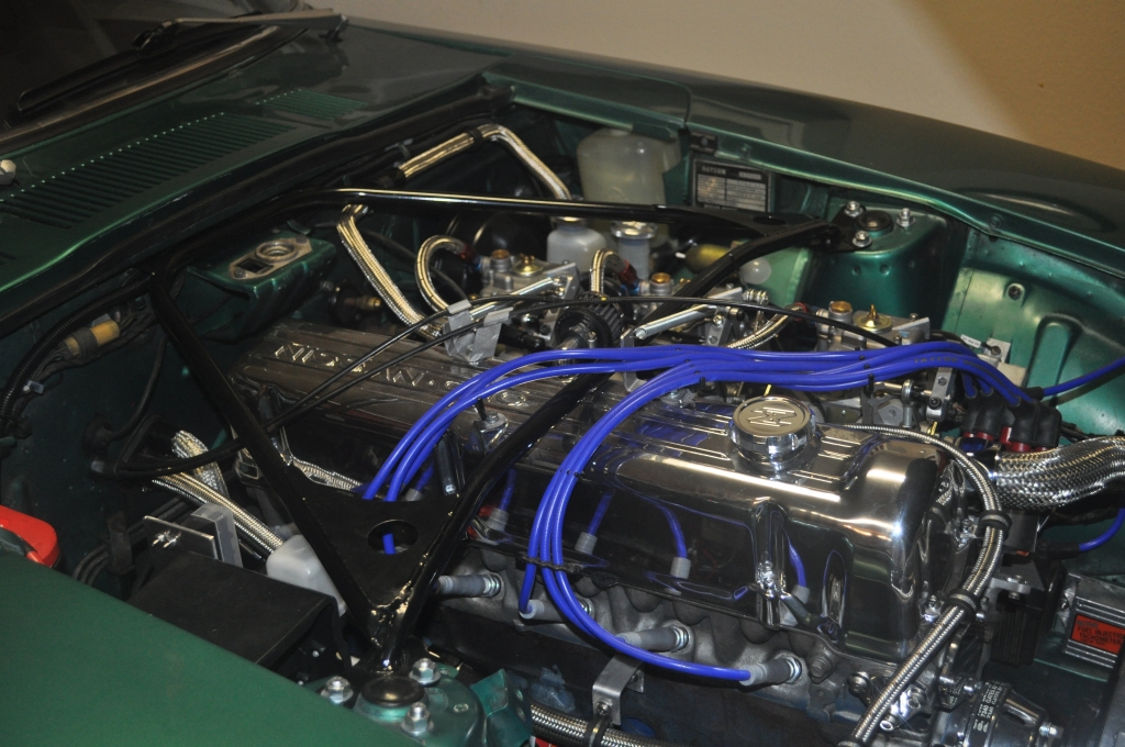

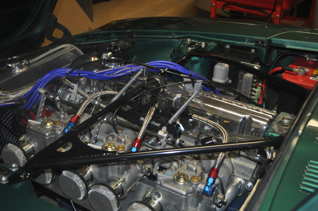

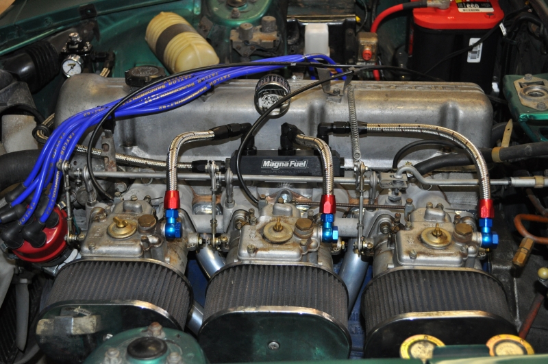

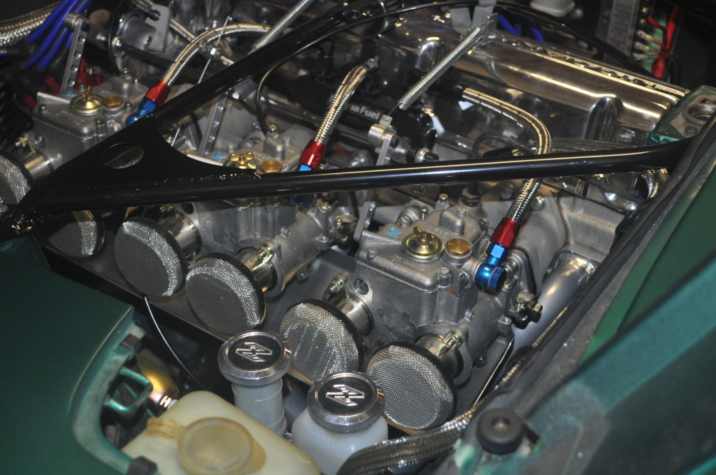

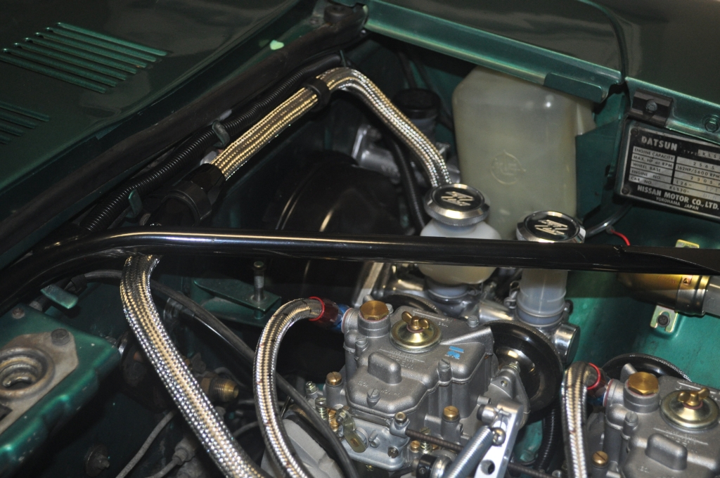

I've attached a few before and after pictures so you can see for yourself. I also apologize for the state of the rest of my engine compartment. I am in the early stages of doing a complete refresh and still have a lot of work ahead, but I at least have the fuel system done.

I've attached a few updated pictures of my engine bay since I completed the SS fuel line upgrade that might help you out.
Hope this helps.
