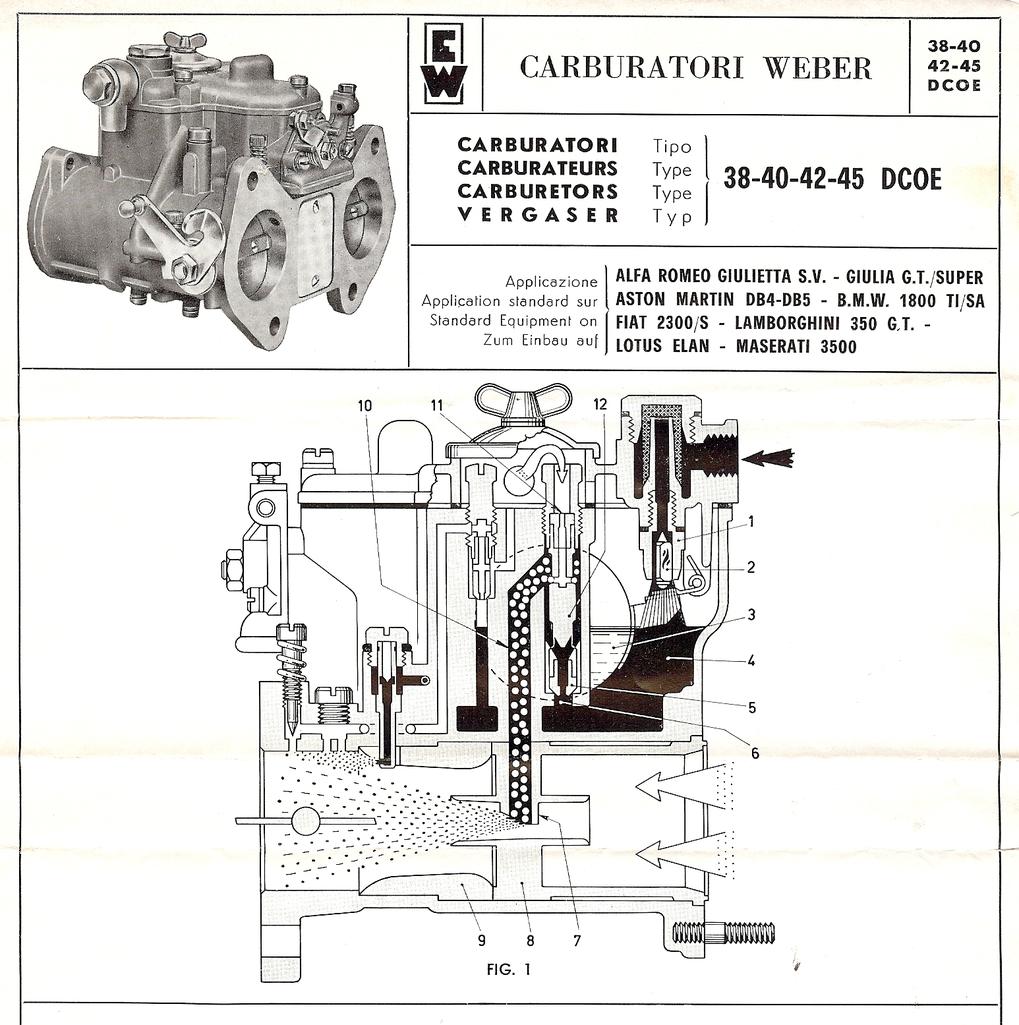

Wow, tough one. I think your only hope is to try to poke the remaining tip out of the hole from the other side. The schematic blowup I have kinda suggests the there may be access from within the main bore directly beneath it, but even so, you'll have to come up with a very small diameter, and very stiff tool, like a 90 degree ended dental pick maybe? to have any hope of pushing it out.
What you may be left with though is a hole that may not perform like the original hole if its too deformed. Even if you drill them out with a small wire drill bit, it may require some welding up and re-drilling with the right size, and in just the right spot. At the very very least, you'll have to make all 6 behave the same way!
That's step two, after you extract those tips.
Good luck

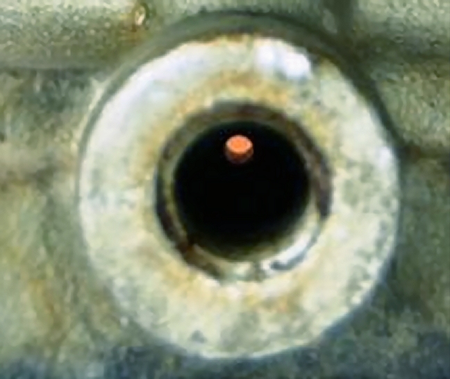

The main reason I've been debating it is because I fear that the passage below the seat (45 DCOE 152) is tapered, so that if i were to drill it, it would not be right - can anybody confirm or deny this?
I already have a 1/16" bit that looks to be just about the right size... tried heating and forcing back through from the carb throat but it only bent broke and mushroomed
yeah, i cant get a good picture, but it looks like the initial seat just below the threads has a quick/shallow taper but then the orifice going down into the throat looks straight walled...?
thanks very much for your help and input
