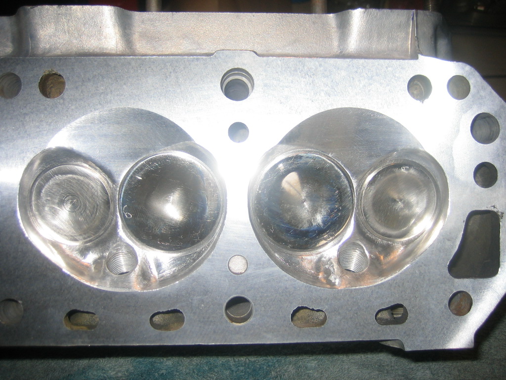

You might have to pull the head to check this but the water jackets run just below the exhaust ports. On my E88 head I had #6 water jacket that ate away at the exhaust port. I found a hole in the bottom of the port. You might try pulling the exhaust manifold and checking the floors of the ports.

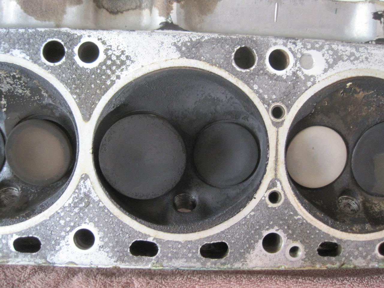

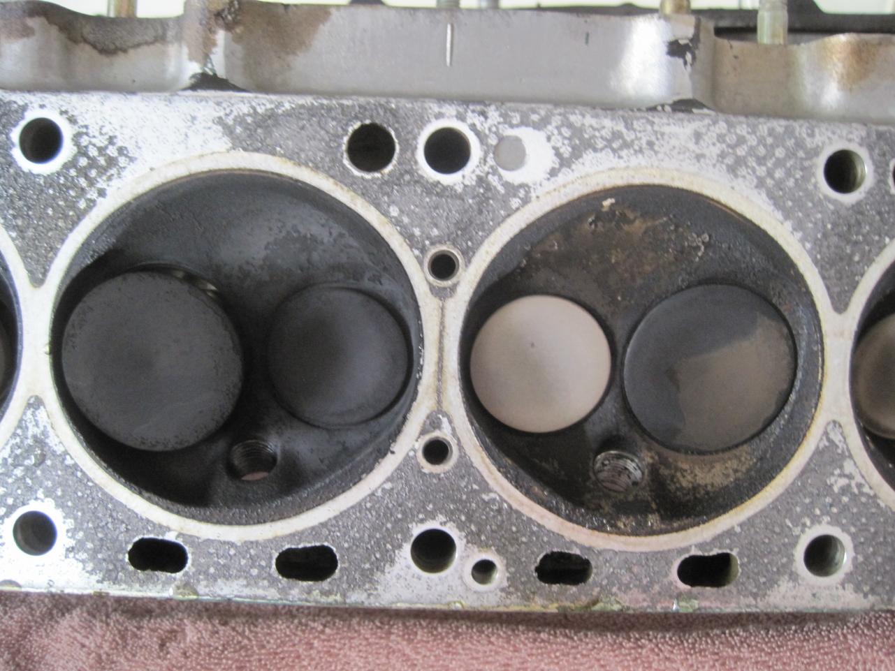

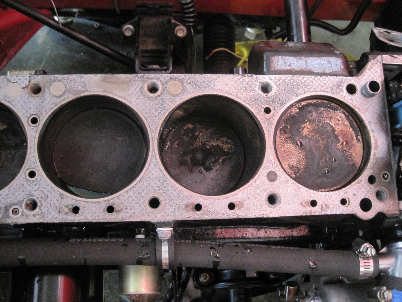

Pulled off the head today and good news and bad news.
Good news is no detonation damage-cylinder walls looked great as well as the combustion chambers.

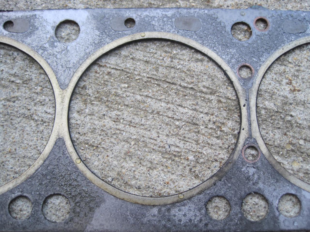

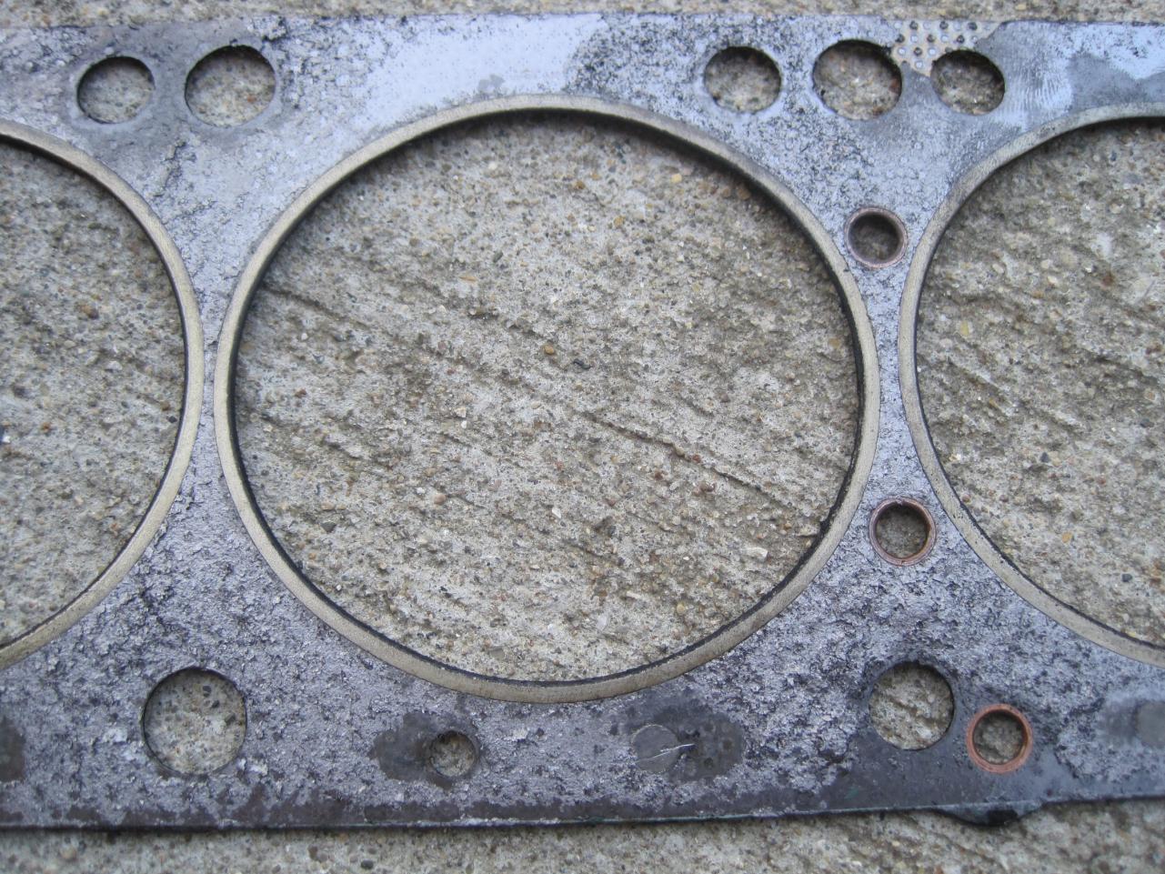

bad news is there is nothing that jumps out at me here as to why the gasket gave out. I can't see anything apparent for the coolant getting into the cylinder. Honestly I haven't been down this road before as far as diagnosing a bad gasket visually. The gasket didn't come off in one piece-some of the material was on both the head and block. The fire rings on the gasket looked okay. I guess I will post up some pics, but number 3 was definitely not burning correctly.
Steve....Did you check your eyebrows in the block to make sure they didn't undercut your gasket? The detail in these pics of the block aren't very good, but it seems to me I remember your previous pics looked like they were pretty deep and wide. Just a thought. Guy
