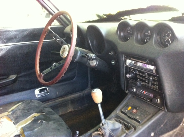

thus, my mind shifts back to that z that has been sitting for 25 years.
so my thoughts are; this could be a great car to learn on. i wouldn't have to fret over messing something up, and i could really get a grasp on all the parts of the vehicle.
especially getting it for say.. $600..
my apprehension lies mostly with the rust.
so i guess in order of importance things that would need to be addressed:
1. mechanical. getting that engine back to life, just as Chris was mentioning, getting it turned over.
2. fixing that rust! ( I would like to get it painted silver... from the orange it has now)
3. exterior damage, i guess i should see how badly rusted the underside is also, and if the body is straight.
what things should I be looking for?
would this be a worthy investment of my time? to learn? i just don't want to jump into something that will be more than i can handle. I'd like to do what i can, but i'm sure there will be things out of my ability.
on another note, my dad likes this idea more. probably because if i end up $600 out.. its not nearly that big a deal.

From those pictures it doesn't look too bad at all, seats look thrashed but that's not a big deal, the dash looks surprisingly nice and uncracked. The only thing concerning me is all the dirt, and the dirt concerns me because dirt traps water and trapped water on metal is rusts playground...
Anyhow you really need to look under the car, check the frame rails!
Overall I say it looks like a great find though. If it has bad rust somewhere important then it's up to if you want a parts car or not. I'll tell you this, if that dash is truly uncracked and in good condition that alone is worth far more then 600.
If you got more questions or see something on the car you aren't sure about put up some more photos or just ask here, but I think rust is your only concern now.
