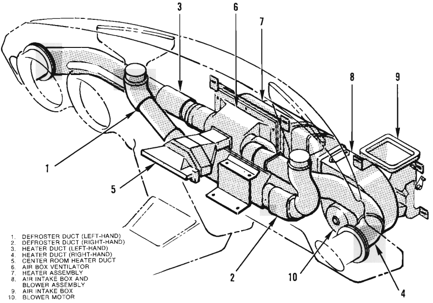

Sorry to hear that Greg. Are there any rules preventing you from adding new parts?
For the stock system, you could try routing the left and right side vents' outlets into the defrost ducts under the dash. This will keep the air temperature humidity the same on both sides of the glass and minimize condensation.
You could improve this by routing coolant hoses through the inner fender passages via metal pipes to warm the air passing through them like a radiator... a valve could control when you need the heat.
The best air for defrosting is re-heated dry from an AC system and heater system so you need a cooler in front of a heater.

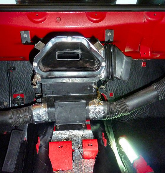

Taping up the plastic ducting joints with foil duct tape helps reduce the air leaks and gets more air out of the ducts. As well, others have upgraded the blower motor with one from a Honda Civic (link) to get more air flow.
