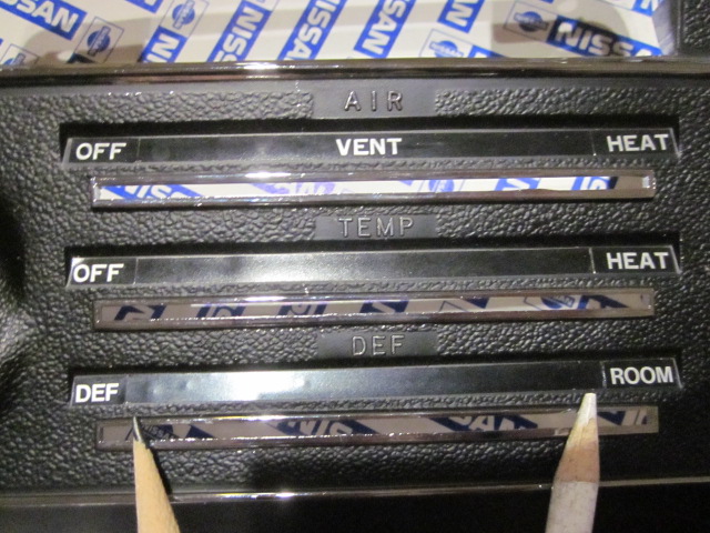

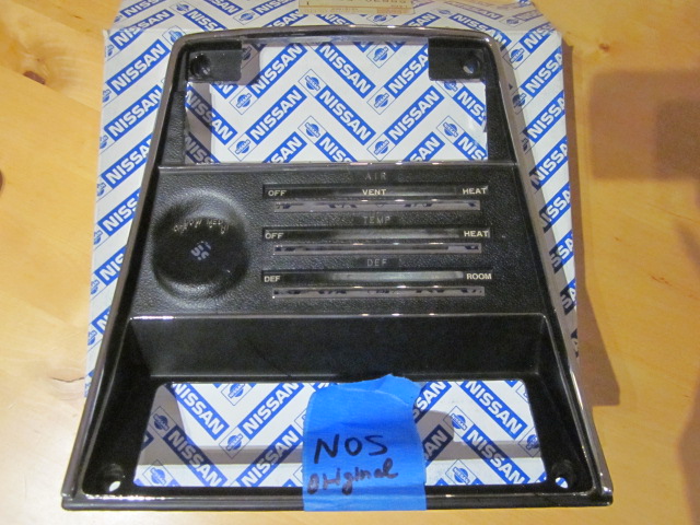

Take a look at the chrome lettering on this NOS part, how do you think it compares?

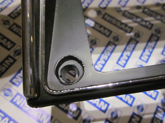

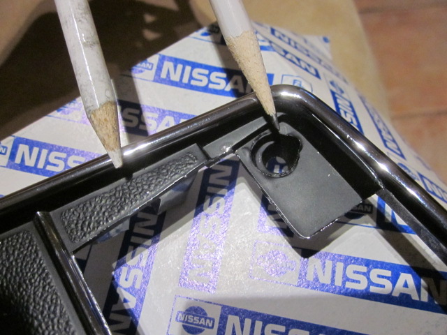

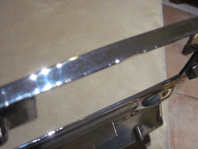

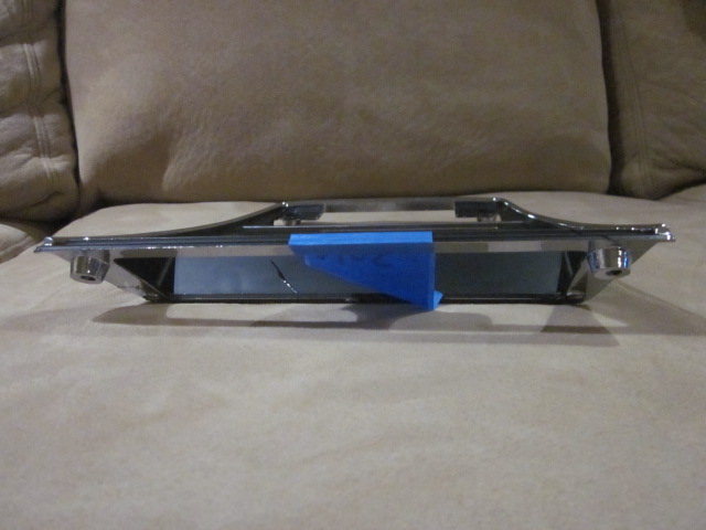

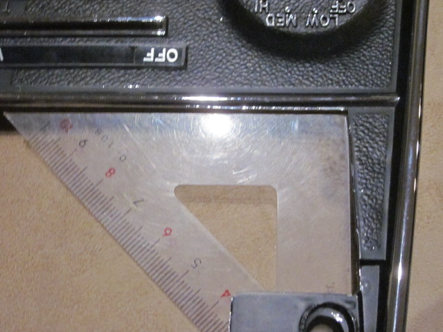

Here I have some of the bad finish on a NOS original one. I have 3 of them and they all look like this.
1. Worped. They are not streight.
2. Pitted chrome
3. Over spray of black paint
4. Heater decals are cut and pasted in 80's as they ran out of LHD version decal. (RHD version decal was cut and pasted for US panel)
5. Some of the holes are mess from being taking out from injection mold.
6. There is almost no Streight line. Everyline was wavy.
7. More and more issues if point out!

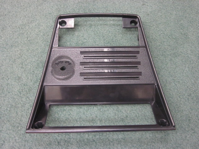

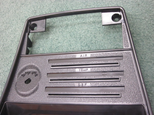

post-16910-14150816811534_thumb.jpgHere is our Black one.
It was measure by hand by every 1 mm, because original was not the quality so that we could digital scan the whole unit.
As close as original in every detail but some areas which needed some design improvement.
