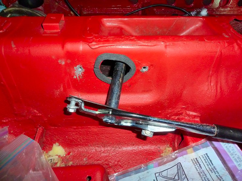

Sealing Hole in Transmission Tunnel at Handbrake
If you remove the handbrake assembly, like I did, you can fab up a 1/4" - 3/16" thick aluminum plate with two holes that line up with the tap holes in the tunnel. I used a large o-ring, think vacuum cleaner drive belt, as the gasket between the tunnel and the aluminum plate.
You can use the o-ring trick even if you leave the handbrake in place.
I used a truck tire innertube to form the gasket and glued an ATV drive shaft boot to it to seal the shaft. I was getting exhaust fumes through that area, thought it was comming from the shifter boot but that was all good, the E brake was the issue, FWIW.
