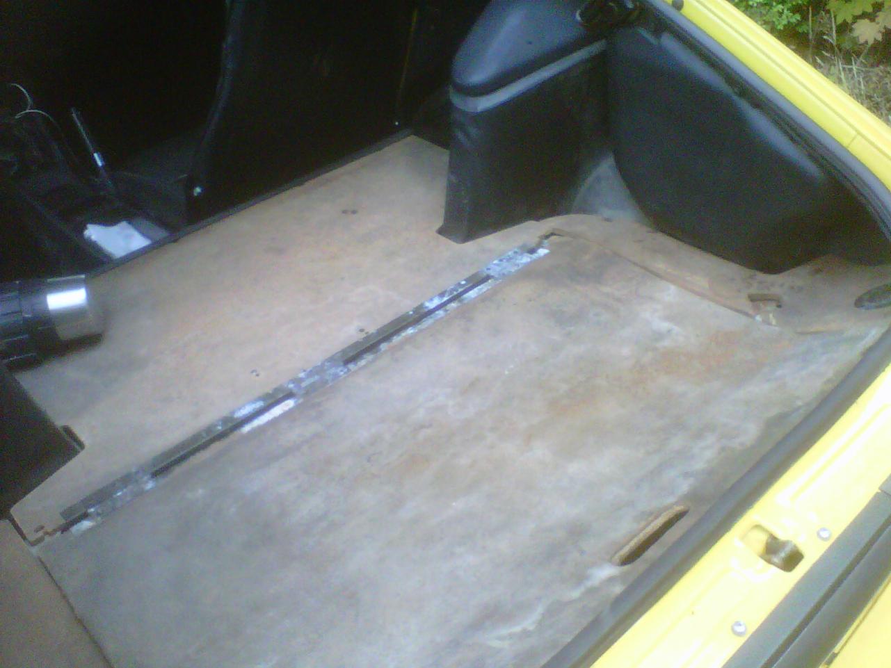

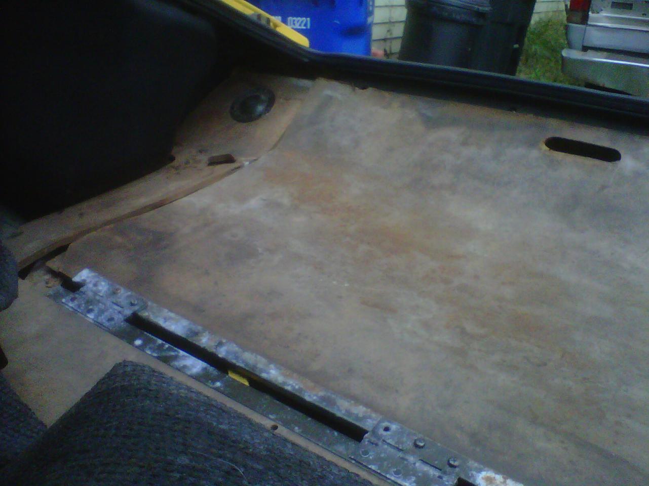

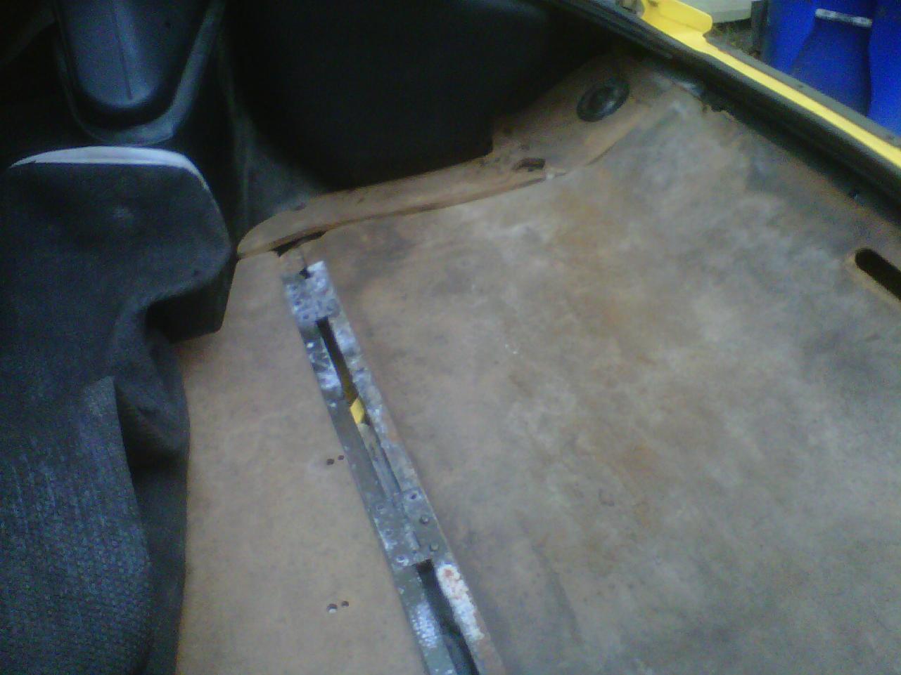

No it is not a custum "mod" it is stock. zKars I have the hardboard what I am trying to figure out is what sort of trim there is in lieu of the more comon taillight cover panel. I am sure there are others that have the sloped deck.I will poast pictures later to show what I have.

Arrg!!! I think some people are not getting it. Some 280Zs had a sloped up deck most do not, most are flat but raised. My car has the former, a sloped up hatch deck. I am not shure I like it but it is stock, not a mod and not stuck. I would prefer the cargo area from my long lost 260z. perhaps some day I will convert it to the flat raised deck. here are some pics. There has to be others out there with a sloped deck.
