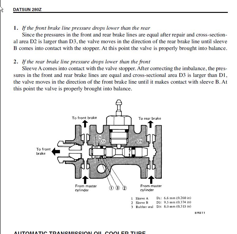

What do you all think? New front brake lines? Could the problem be in the Brake warning light valve (I think that is what it is called)
Aside from a warning light, what that valve really does is meter the pressure balance between your front and back brakes. It is called a proportioning valve in some cases. The light works off it as an auxiliary benefit

Also, I guess these cars basically have 2 proportioning valves.. one that is close to the master cylinder and one that is on the firewall?
Check Master Cyl, then clean the Proportioning Valve, then completely remove the Bleeder screws in the calipers and make sure that there is not some crap clogging up the port. Tip: you can use some electric trimmer line to rod out the ports and hard lines to push out any debris.
