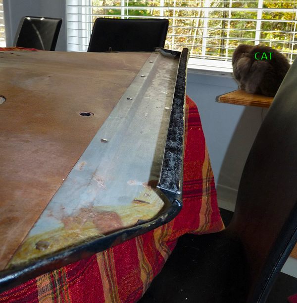

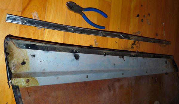

The fuzzy window trim is actually a metal strip with a ribbon of fuzzy material contained within it to make an assembly.This was then stapled to the door panel's top metal section using an industrial stapler.
Here you can see most of the fuzz removed except at the rusty old staples.

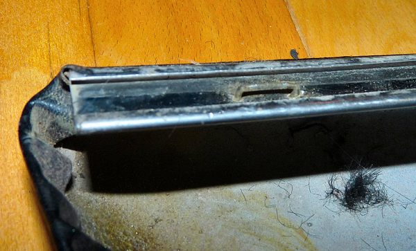

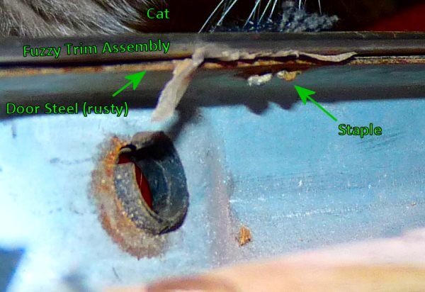

Close-up shot of a staple
Details of the fastening.

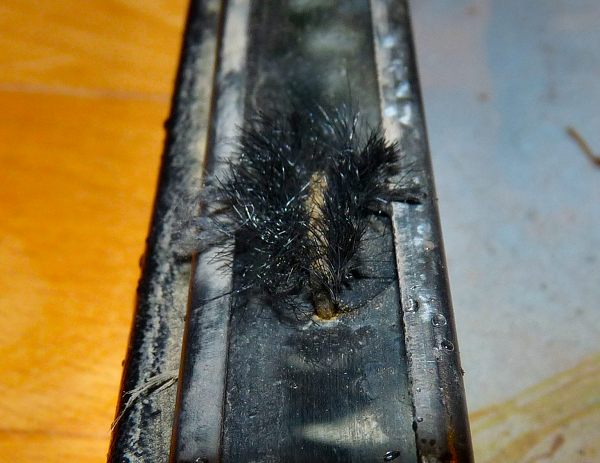

Fuzz removed and staple exposed.
I used cutters to remove the staples... not a fun job but not too difficult.

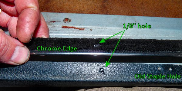

The first step was to align the new fuzzy trim assembly where the old was.
The trim I purchased from Black Dragon had a chrome and black edge. I decided on the chrome to be up.

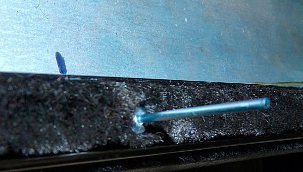

Once aligned, hold the trim assembly in place and drill a 1/8" hole through it and through the metal door panel. Drill only one hole for now in the middle of the door.

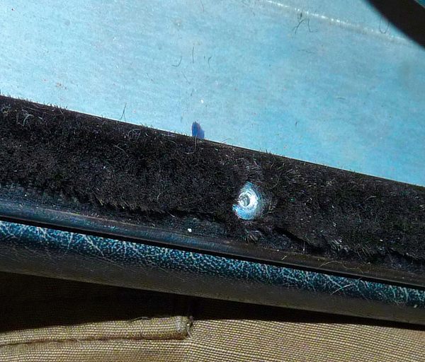

Insert the rivet.
Fasten. Then repeat working from the centre out to the edges.
Finished.... and you can't see the rivets.
The cat got bored.
Now that I am posting this tech tip, an idea has come to mind that is too late for me: You may wish to paint/sharpie marker the rivet heads black.

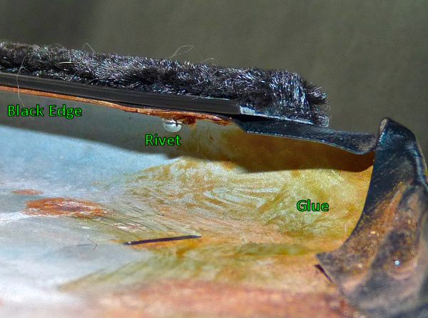

Cross section detail and you can see the alternate black edge.

I used rivets on mine as well. The only things I would add are: 1)try to move the hairs from beneath the rivet head so that there will be more of them to cover over it and 2) if the head sticks up to much you may want to burnish it down with a dremmel.
