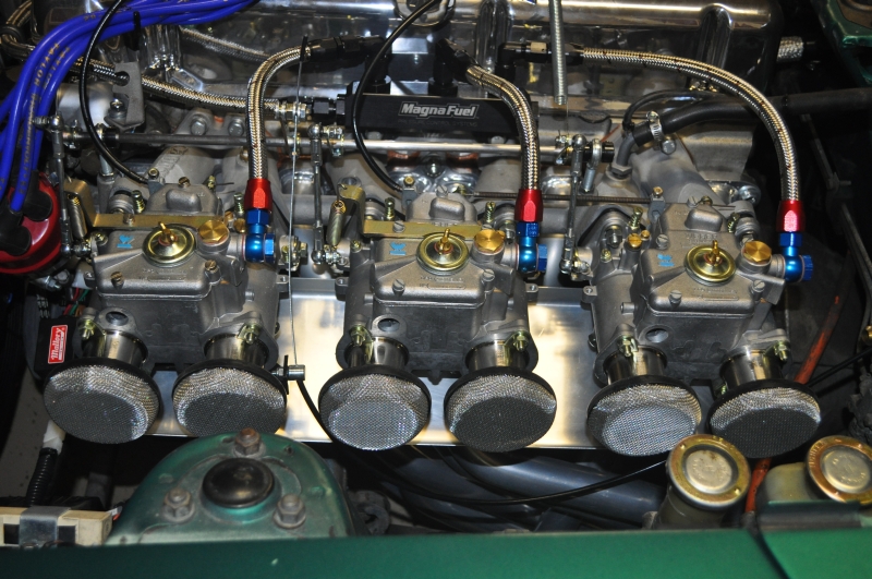

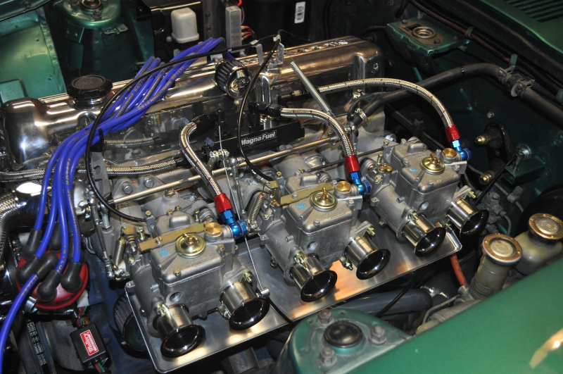

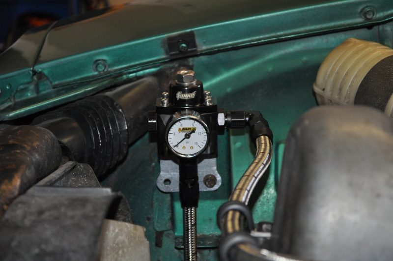

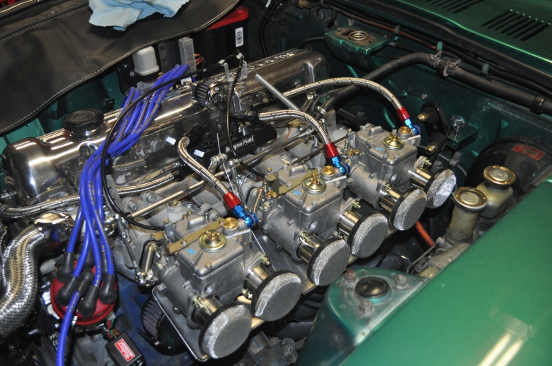

I also run triple Webers (40DCOE's), but had to fabricate the fuel line that I wanted from individual components. I could not find anything that was off the shelf that met the design goals that I had, including the use of all stainless steel braided lines. I have the whole design documented as well as a bill of material if you are interested. This includes not just the fuel lines, but also the pump setup and regulator that I used.
I am not familiar with the Holley regulatr that you selected, but I do know that when I was researching my system there were distinct differences between regulators that required a return line and those that did not. If you plan to use a return you might need to check on the capability of the regulator that you selected to ensure that it supports a return line. I've attached a few pictures of my setup for your reference.

The Webers do not have a choke circuit per se, but they do have an enrichment circuit that will help during cold starts. The choke cables are the original OEM cables that I cut so that I could use them to engage the enrichment circuit on a dead cold start. That is what you are seeing.
I will say however that for the most part, I never really have to use them especially given the weather here in Texas. I find that typically on a cold start, all I have to do is pump the carbs a few times and the accel pumps provide sufficient fuel to start the engine and so the effect of the chokes is not really necessary Since I have taken this picture, I have actually removed those cables and cleaned up the engine compartment a bit. I also replaced my center console recently and wanted to avoid the console cracking issue where the choke assembly attaches to the console so at least for the time being I have taken them off.
