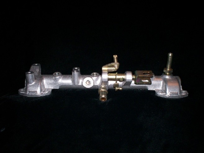

There is nothing at all on my balance tube. It was all taken off when I got my total Z therapy treatment.

I really doubt that ZT would plug the PCV hole (why?), are you 100% sure that there is no hose coming from the block breather that attaches to the bottom of your balance tube as the FSM depicts? If there isn't then check to make sure that you don't have a huge, gaping hole or a PCV valve sitting all by itself in the bottom of your balance tube.

I just took a look at ZTherapy's site.
Here is what they say about their balance tube:
Smooth and clean 240Z Intake/Balance Tube, polished and plated--no smog, no control valves, no vac taps. Water heating still works, if desired. Crankcase breather and Valve cover breather fittings intact. Includes firewall linkage, carb mounting nuts, washers, lock washers. Cleaned up insulator with new gaskets. Your choice of intakes (240Z water, 240Z no water, 260Z, with a 240Z balance tube. Extraneous holes are plugged. Basically all the junk on the balance tube is deleted (Smog equipment available at additional cost)
Here is their photo (PCV valve front and center):
You must have the crankcase breather hose attached to the PCV valve. Otherwise, you have a giant vacuum leak in your intake making you run very lean.
