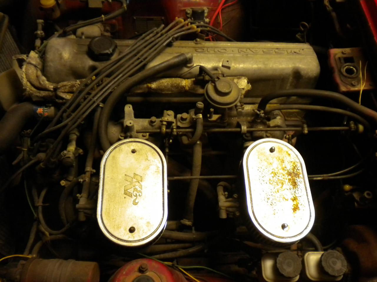

26th-z you have a good point. In the last 24 hours he has learned how to find the ID number on the block, change/gap spark plugs, bleed brakes and replace the throttle return spring. While he was changing the spark plugs he learned the hard way to remove the spark plug wires from the boot and not by yanking on the wire. So then he learned how to repair the spark plug wire/boot. Next he will need to ID the holly carbs and buy two rebuild kits. I'll rebuild one as he learns and he will do the 2nd. After that he will learn how to do the timing and hopefully the engine will run smooth.
That's an unusual set-up. I've seen a single Holly replace the dual side-drafts, but not two.
My mistake. I thought he told us it was holly but you are correct about it being a Weber. When we go a buy the rebuild kit how do I know what kit I need? Are those carbs stock?
Edited by derbyD
They should be Weber DGV 32/36 carbs. I am not a DGV expert by any means, but that is the typical Weber down drought carb for the Z.
Thank you all, you guys are great.
They could also be Holley 5200's (Pinto carbs). They will fit the same manifold as a Weber 32/36 DGV and were fairly plentiful back 'in the day'. Hard to tell with the air cleaners on........
