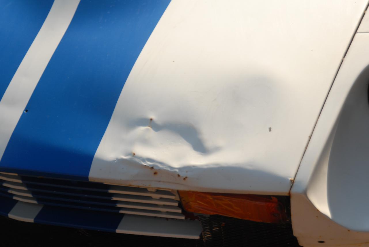

I know it may be difficult to tell for sure but for those out there that are body guys how would you repair the damage in the attached photo. This is really the only real body work that needs to be done on my car before painting. I am hoping that I do not need to get a new hood.post-24101-14150819333578_thumb.jpg

I know it may be difficult to tell for sure but for those out there that are body guys how would you repair the damage in the attached photo. This is really the only real body work that needs to be done on my car before painting. I am hoping that I do not need to get a new hood.[ATTACH=CONFIG]54323[/ATTACH]
Hammer, doly and heat.
I have never done any hammer-on-dolly work and very little dent repair work of any kind. Will I be able to get one type of dolly and one type of hammer for this job based on what you can see from the photo. Also where can those type of tools be purchased? Are they expensive? I will check around.
I am not really sure I can get to the back side of the hood. I will need to look. Sorry not with the car right now.
