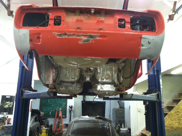

I pushed the car onto the lift, and began disassembling it. I removed the front and rear suspension, and interior. Next I began the entertaining task of removing the undercoating from the bottom of the car. It turns out the car has a bit more rust than I had seen, but still pretty solid. Rust so far is confined to floors, and battery area. I purchased new floors, and floor stiffeners. That work will start after I get the rest of the undercoating off. My goal is to have a nice body color finish on the bottom of the car.

Spent a bit more time on the under-coating this evening. I had been using dry ice to cool the under-coating off and make it brittle, but difficult to do on the vertical, and compound curve areas (like the wheel arches). I had heard that the canned "air," for cleaning keyboards, etc., gets really cold if you turn it upside down and spray it. Well it works pretty darn good. I did the spare tire well the other night laying dry ice from the inside, and then scraping the undercoating off with a harbor freight oscillating scraper. It took me a couple of hours to get to the point it is in the photo. I used the inverted can on the wheel arch. I would "cool down," an area about 6 inches square, and then hit it with the oscillating scraper. I only spent about a half an hour and got it pretty clean. Came in to eat dinner, I think I'll head back out to the shop for awhile this evening.

Got the shop warmed up and spent some more quality time battling the undercoating. I have been wanting to try a needle scaler, but did not own one, so I bought a cheap harbor freight one yesterday to try out. Wow, that thing works great, especially for the nooks and crannies. I would freeze a section with the "canned air," and then buzz it with the needle scaler, and the nasty black stuff pops off pretty slick. I spent about 5 hours, and pretty much finished the the whole tub from the front fenders back. I started working on the front inner fenders, but the needle scaler gave up. I guess you get what you pay for! I am going to try to exchange it today, I'll spend the 6 bucks and get the 2 year warranty this time. I hope to get the fenders off, and clean up the inner fenders today. I am also going over to my buddies shop to help get their "Chump Car," ready for an eight hour race at Laguna Seca the 22nd of this month. I attached a picture of the Chump car, with my roadster at the 24 hour Spokane race this summer, which they won! That's about it for now.
