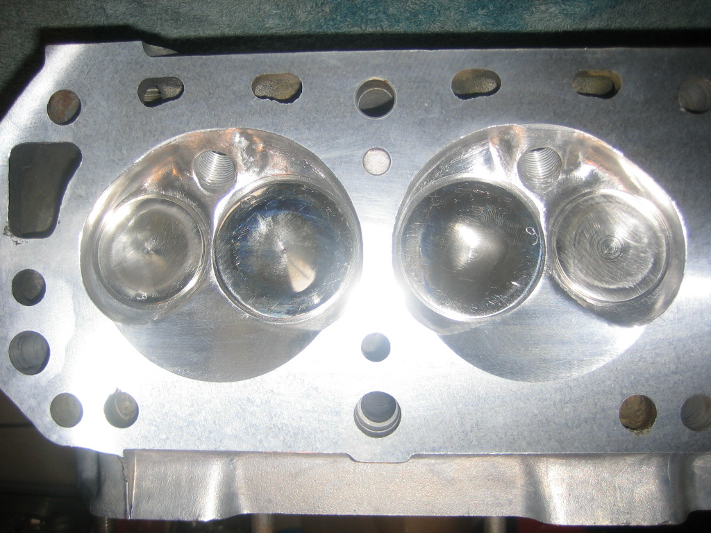

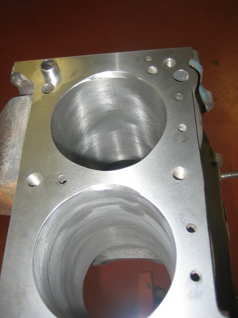

Notching the block means removing metal from the top of the cylinder near where the valve opens up. Generally this is done by tracing the headgasket onto the block and removing metal with a die grinder. Same can be done for the head, which is called unshrouding the valves. Whether you need to do this or not is a different story. For Dave I think this would be wasted effort. The reduction in compression from removing the metal is probably about the same as the increase that could be expected from better flow. He's not racing, and doesn't have the rest of the head optimized (port and polished, cc'd chambers, etc). If it's an all out race build with custom pistons and really high compression, then it makes more sense to worry about that stuff.

Well Jon,
you just kind of confirmed everything I sent to Dave in a PM. I mentioned unshrouded based on what i have read from Racer Brown articles-that basically every head shoud be unshrouded for breathing purposes. Also for the fact that if larger valves are possibly installed and if the head needs to be resurfaced that unshrouding won't hurt -just help.
Glad you weighed in on the OP theory. Still like to see his results from a mixed batch of engine parts!!!
Couple of pics for you Dave
