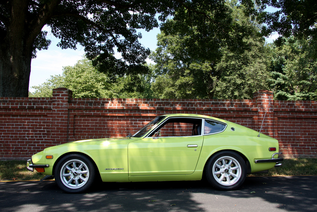

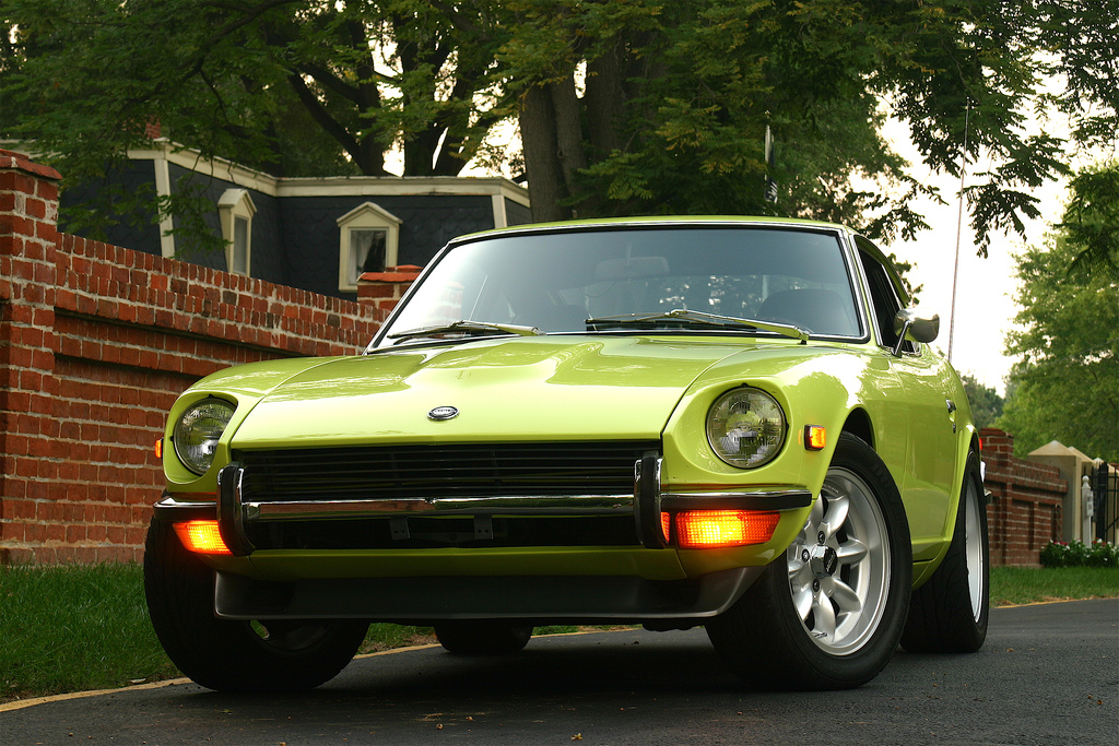

Here's my setup. Tokico 1" drop springs and Tokico struts.
15 inch American Ansen wheels and Michelin 205/60/15s Pilot Exalto AS.
Bought the car with the setup. Ride is a little
bouncy but not too bad.
