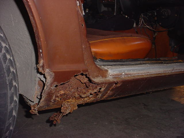

Unfortunately sandblasting is going to be the easy part of the job.
The dog leg is completely gone as is the inner fender panel that seals the dog leg area to the open end of the rocker panel.:sick:

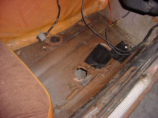

Floor looks to have a good bit of rust as well, and that hole in the roof looks scary as well. The floor and rocker panel will be fairly easy to repair as repair panels are available as well as the inner fender panel to repair the dog leg.
The hole in the roof is going to be the most difficult as it looks like the rust has come from under the windshield gasket and I wouldn't be surprised if after taking the windshield out, you are going to find even more rust. This is going to be one very dificult area to fix as it is where the roof panel meets the windshield header....It is going to take a lot of welding and filling to make get this right and have it look right and not leak water into the interior.....
With the damage shown, I would be surprised if there aren't other rusted out areas that haven't been found yet.:disappoin

At a WAG, I would say that you have at least a couple thousand in just the areas you've shown. Your floorpan shows that there is some serious rust there, which says that it's progressed beneath the tar mats. Also the inner part of the rocker panel is bound to be rusted. The dogleg behind the rocker panel is gone, which means you have 3 different pieces of sheet metal to replace there, which tells me that your rear wheel fender lips are bound to also be shot and needing work. The roof rot, as has been mentioned may be isolated, but in fact may be the whole top edge of the roof. All those add up and I would not be surprised to find out that your sheet metal repair ALONE will be in the vicinity of 3-4 thousand. And that's before you start replacing carpets, vinyl, seats, dash, emblems etc etc.
All of these ARE repairable, but from what I see, you're going to be into it for at least 3-4 before you get to the next phase, and then you're looking at another 2-3k. Now mind you, I'm presuming YOU are going to do the work. If you have others do it, multiply by about 3 whatever estimate you have now.
You might definitely be better off buying a rolling shell in good condition and take the parts from this car that are good and transplant them.
