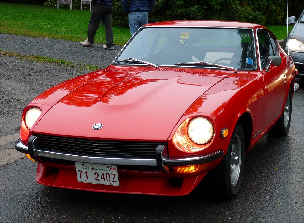

Returned Jan 1971 240z to its original owner after restoration. 500km drive to deliver. Enjoyable and very peppy motor.

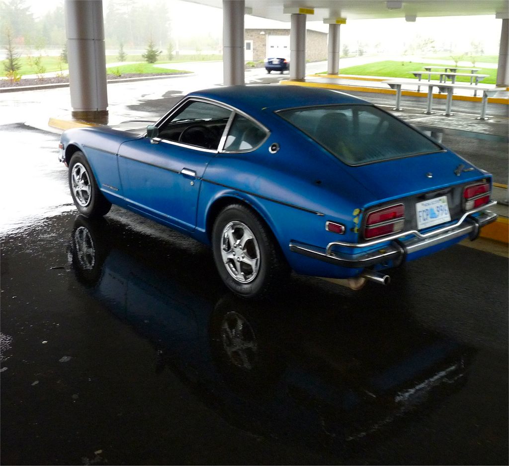

Picked up a Dec 1971 240z to restore for myself. Only 86,000km. Very quiet differential and 1/2hafts...never ever experienced that. Motor purrs and it difficult to hear at idle. Some rust and bumps from over the years but solid and original. Was 112 Yellow but someone canned-it blue.
Not sure what colour to paint it. Japanese racing white maybe. I just plan to simply refresh the parts and plate all of the metal. I'll try to keep as much stock as I can. Still wondering if I should keep it electric lime.

I drove the red 71 for 500km with the spook @ 70-80mph and immediately after the blue 71 w/o the spook for the same time and speed. The spook really makes a difference, especially when passing big rigs; not so floaty.

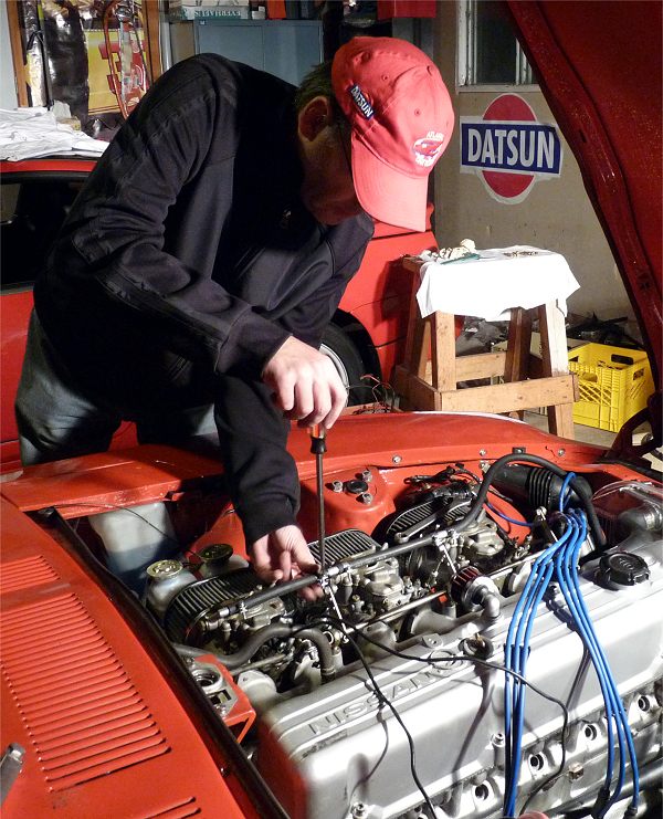

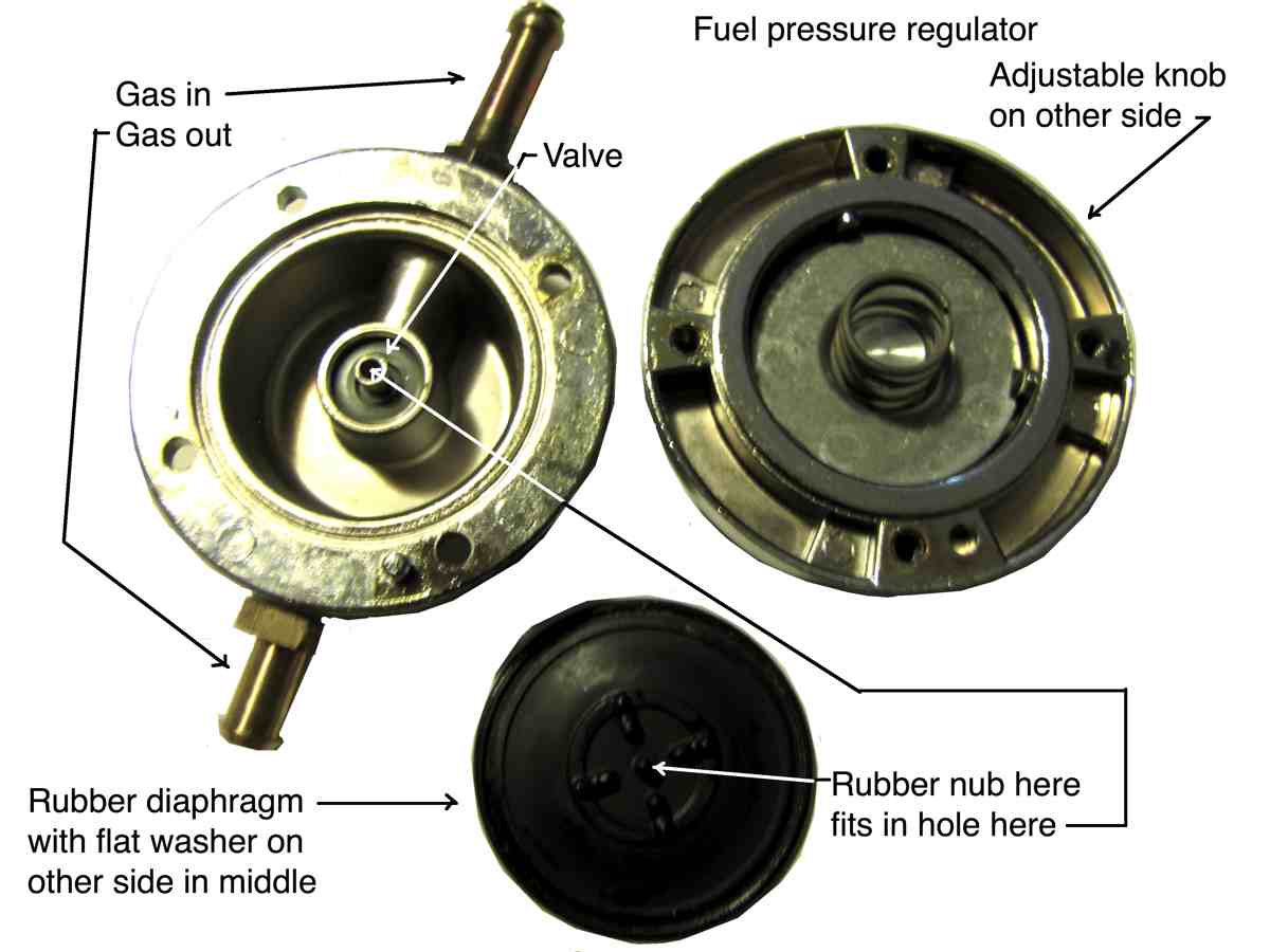

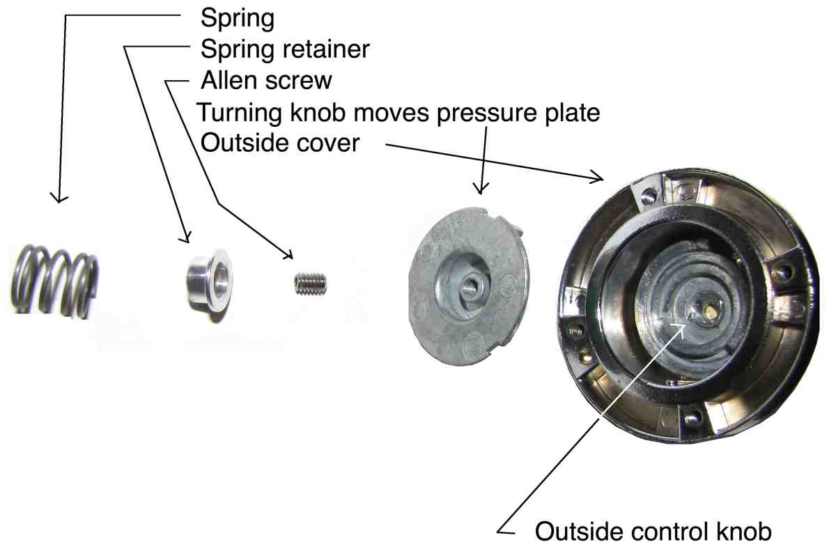

Hi all,
I went to sync the carbs after a failed start and noticed both carbs were overflowing gas out of the bottom of the carb where the nozzle is. That got my attention as visions of an engine fire or a garage fire went through my mind. I have a cutoff circuit that cuts off the fuel pump if the engine stops and this may have prevented a fire. The PO had converted to an electric fuel pump with a pressure regulator. As both carbs were overflowing that seemed to point to something in common so I took the pressure regulator apart. For some reason the allen screw that aligns the pressure so that a knob indicated 3 PSI really is 3 PSI had no setscrew and could be turned easily with my fingernail. It had turned by itself over time and began allowing most of the fuel pump pressure to go through unimpeded to the carbs. I don't know if the setscrew fell out when I disassembled the regulator or if the factory forgot to put one in. I did replace the regulator with a new one for safety but took the old one and intentionally damaged the threads of the allen screw to keep it from easily turning and reassembled the old regulator aligning it to proper pressure by use of a fuel pressure gauge while blowing in the regulator inlet. I need more work like this I never could quite hit 3 PSI.
