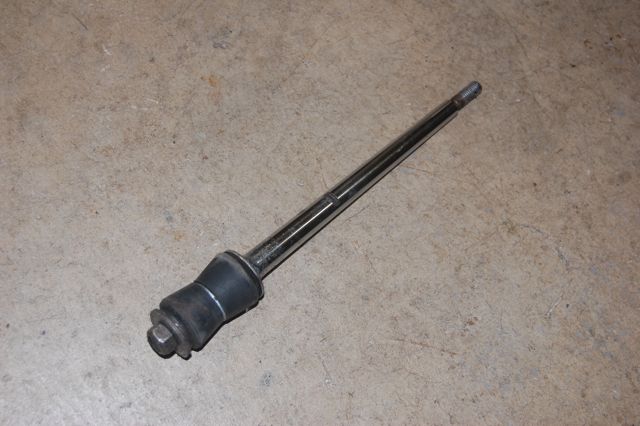

You beat me to the reply Arne. I was trying to find some pictures to show the difference. The linkage on the early, versus late 4 speeds are different. The early one uses a completely straight stick that is bolted in at the bottom. The later style uses a fulcrum in the middle to bolt it in. Well, it's more of a pin, with a "C" clip that holds it in. I cut and welded the shifter in the early '71 first. It did allow me to fit it in their without cutting. However, the stock trans boot bunched up so badly that it made the trans slip out of 3rd and 5th gear. I ended up cutting the tunnel anyway, since it was not acceptable to have the trans pop out of gear on the track!!

There is no standard lever that will work for a late transmission (either 4 or 5 speed) in an unmodified '70-71 body shell. In the later transmissions the shift lever is about 1.5" farther forward (from memory, correct me if I'm wrong) than the early transmissions. You either need to enlarge the opening in the tunnel forward by 2" or so, or modify a later shift lever to fit the smaller opening.
Here is an early shifter:
Here is a (broken) modified late lever for early tunnel opening:
