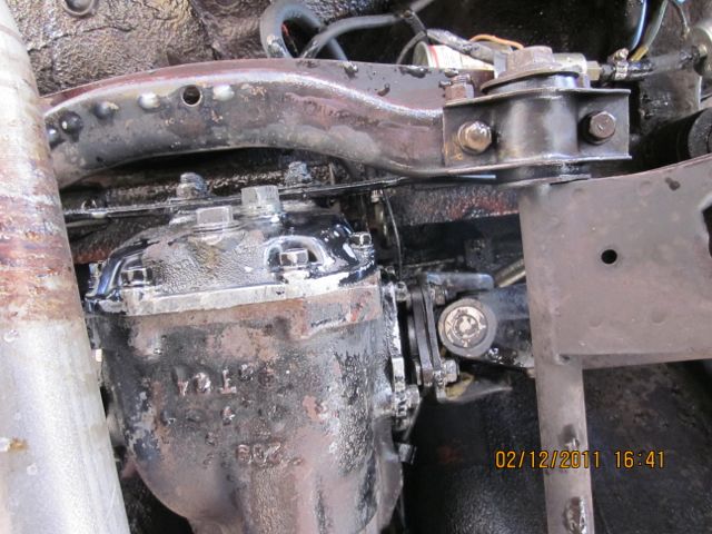

I can't really take photos right now because I have the front end in the air and their just ain't that much room left under the backside. I am attaching a photo of the offending bracket. Note the slightly squarshed looking rubber bushing. Didn't realize the significance of it at the time, but this is what I eventually took a small sledge to. I loosened maybe ten to twelve nuts or bolts in all. Any and all of the bolts that attach the differential carrier to the body, including the indirect attachment through the "dog legs." Nuts and bolts attaching the differential to the carrier, I did _not_ loosen. One of the dog legs was bent, but only because it was forced out of position. Once I whacked the bracket into place, the dog leg straightened out and hung nice and perpendicular to the ground.

This is great stuff, thanks for the picture! It took me a couple days of staring at that picture and reading your posts before I fully understood it. Had to dig all the old four-bar linkage stuff from my college days out of the recesses of my brain. It does make sense, a tweek on a very small bracket at the inner end can translate to a large discrepency when placed across a 14-inch swing arm.
I'm guessing you didn't loosen the bolts much, maybe a half turn or so, just enough to maintain component contact and reduce friction enough to be able to push the parts around?

Actually, it did more than affect the toe. I had the car parallel to the ground a foot and a half in the air and dropped many a line for point-to-point measures. I can't pretend to tell you the mechanism, but every measure I took indicated that center of the rear hubs moved, bringing the right and left wheelbase much closer in length. Professional before and after thrust angle measures also showed a much closer alignment with the body.
