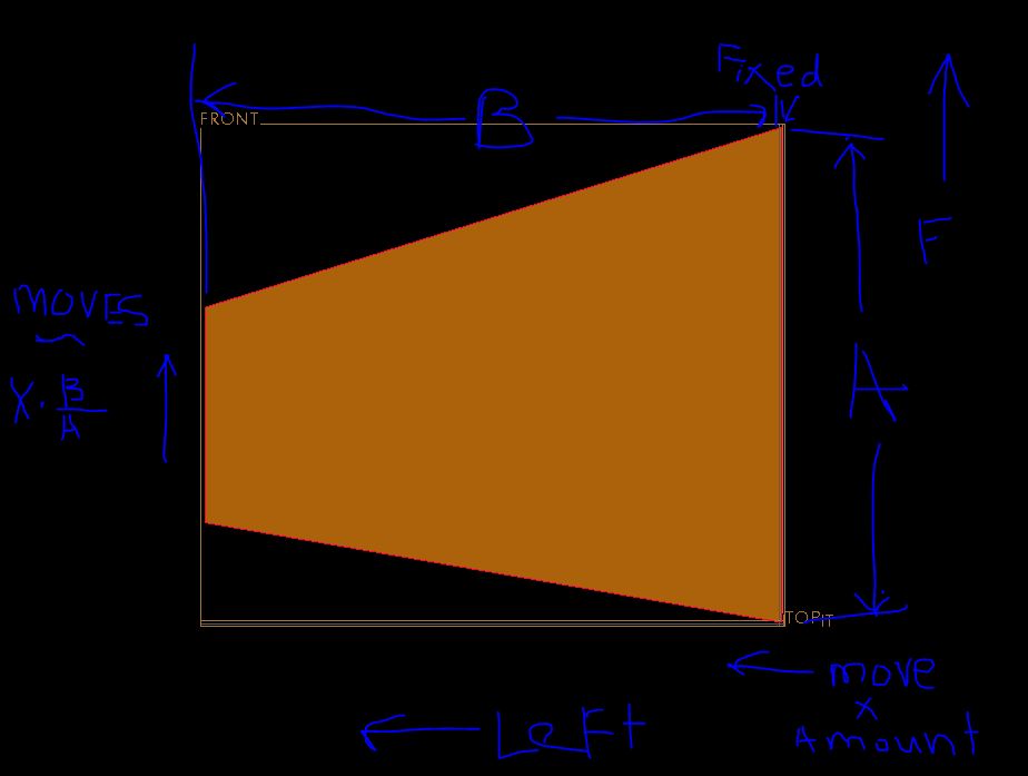

The hub will move for and aft if you only move one LCA bushing location. The whole LCA pivots about the fixed bushing swinging the wheel side of the LCA. A small amount but it will move approximately by..
(the amount the rear bushing was moved ) * ((Distance from LCA shaft to hub)/(distance front to rear of the LCA bushings))

Doradox wrote: The hub will move for and aft if you only move one LCA bushing location. The whole LCA pivots about the fixed bushing swinging the wheel side of the LCA. A small amount but it will move approximately by..

You cannot move the front pivot of the control arm, as its location is a welded part of the frame. If you move the rear pivots, you can change the toe. You can't significantly change the wheelbase. Using doradox's formula and estimating the control arm length fore/aft at 12 inches and the width at 14.5" (I know the width is correct), a 1/4" toe change (which is a big change) gets .3" of movement at the hub. You said that the upright moved .1". That would translate to a hub change of .120".
