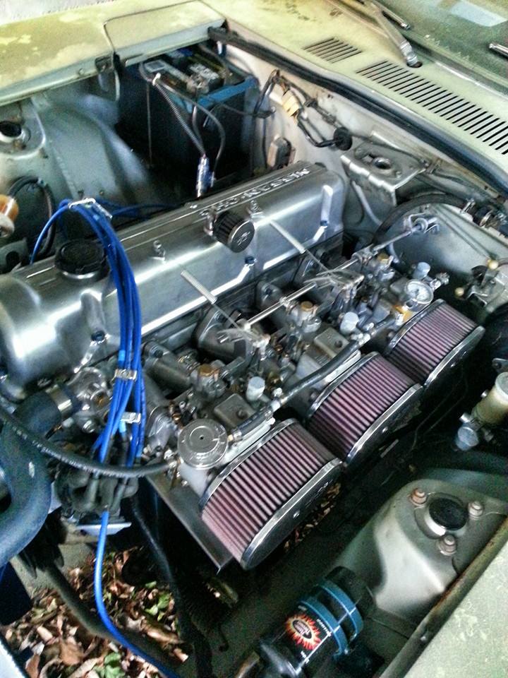

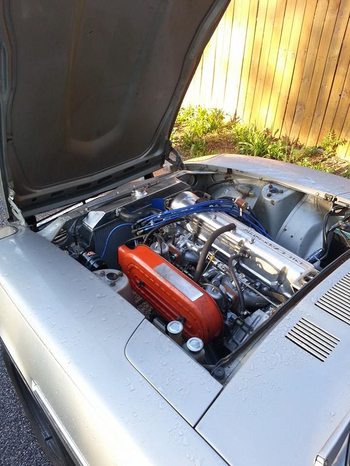

Get some kind of filtration on that thing sir!!!!
I do not want your new engine to suck up dirt!
The K&N air filters actually arrived from Pegasus Racing on April 30th I just didn't make the time to post an update. I'm a lot more willing to go for longer drives now. I did not factor the cost of the K&Ns into the figure for the carbs. It hurt a little. I keep thinking I'm done with spending money!

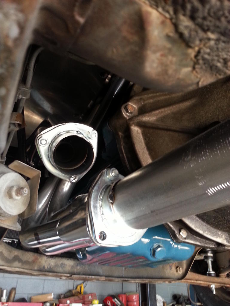

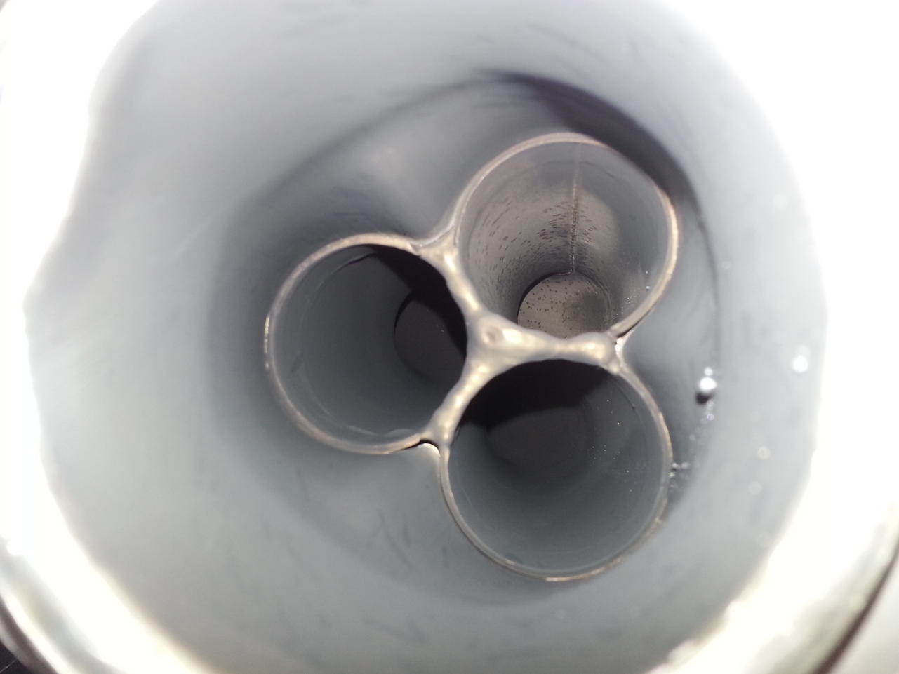

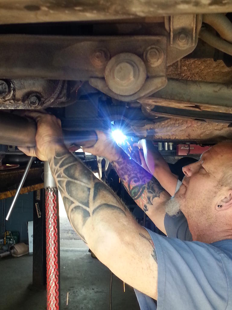

Since the last update I took the carbs, intake, and exhaust off. I figured I might as well get my NOS Jet Hot coated Clifford Research header put on with an exhaust made by a real shop instead of the hack job that was on there before.
After some research and a recommendation I found Eddie's Custom Exhaust Shop in Augusta, GA. I got an estimate of $160 for 2.5" pipe including making the header extension from the 6-3-2 header.

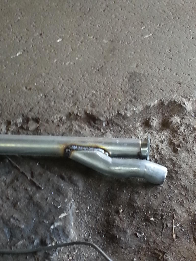

The owner told me I needed to supply the header reducers. After ordering from NAPA for $26.99 and waiting two days for delivery, they sold me a set for larger headers. The exhaust shop sent me to a local race shop I had never heard of. After walking in the 10-bay garage seeing all sorts of sweet rides, the owner of this shop guided me into the store area. There were about 15 isles of all the race parts you only ever find online. Ignition, AN fittings, fuel pumps, the whole nine yards. Fully built 383s and polished rear ends. I was like a kid in a candy store. The local race shop sold me the reducers I needed (pre welded together I might add) for $16.99.

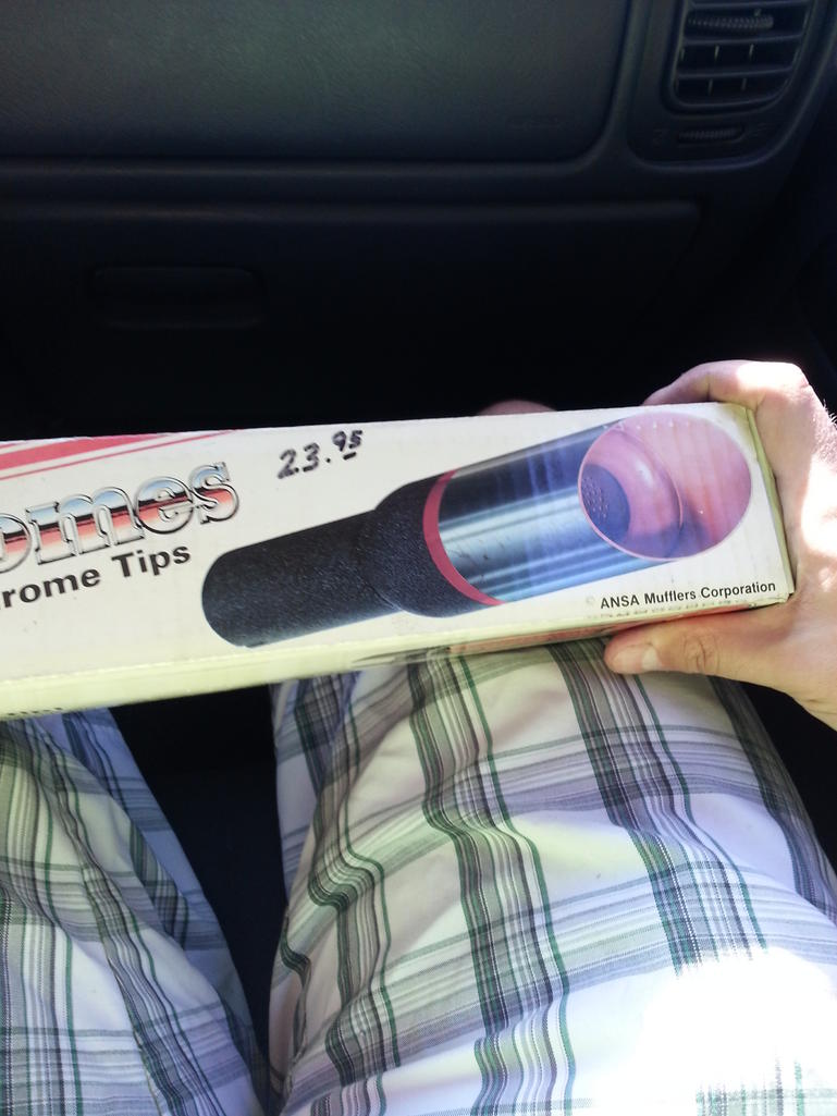

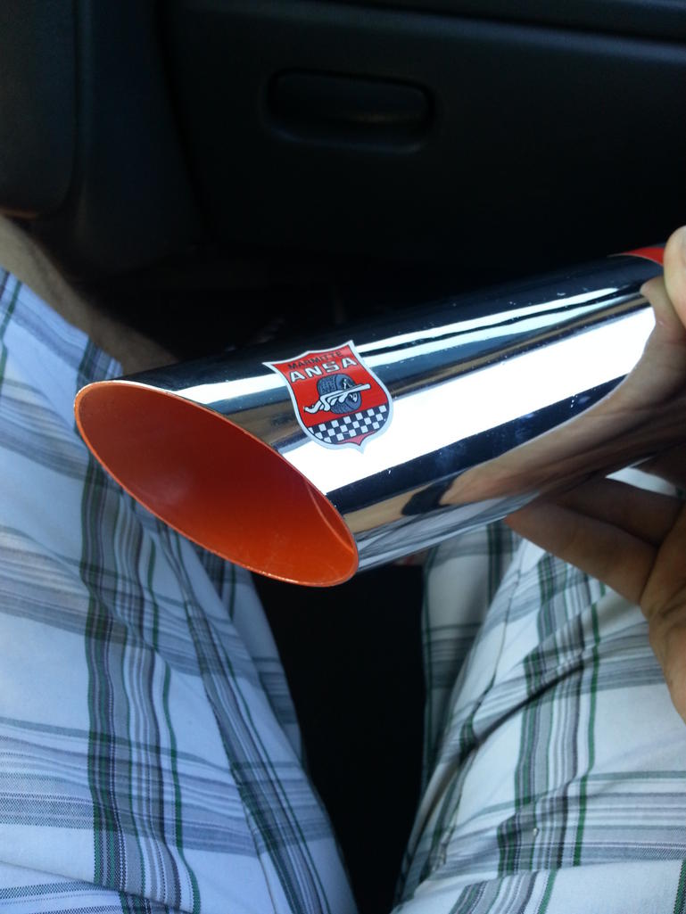

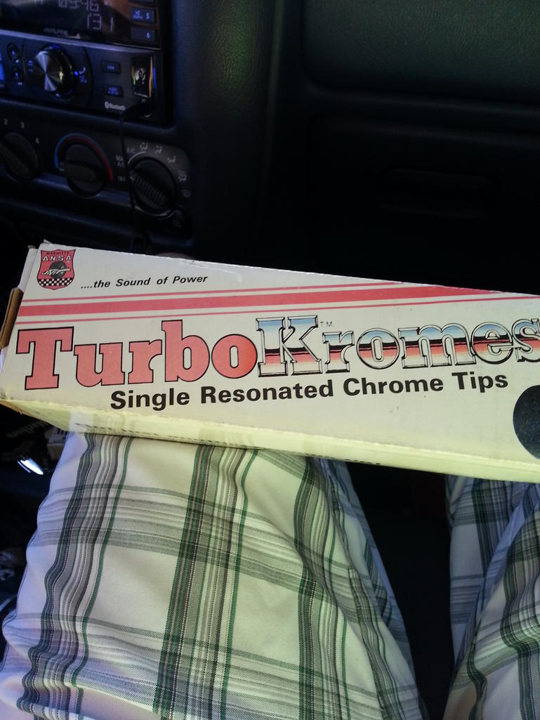

As the guy was ringing me up I asked if he had any exhaust tips for sale. He pointed to the other side of the wall and I could not believe what I saw. A NOS ANSA tip! I asked if he had another and he said there should be another in the box. I could not believe it and I felt incredibly lucky to have gone into this shop. I'm going to eventually weld them together and turn it into a twin tip design. I suppose this makes up for when WingZr0 ripped a few of us off for $400 a piece.

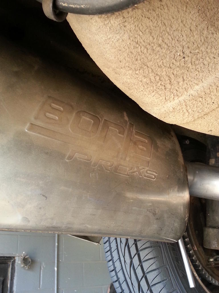

The exhaust shop finished around 1 p.m. after dealing with the hiccups. Instead of going for a Flowmaster or Magnaflow muffler, I opted for a used Borla Pro XS he offered me for $20. Overall I'm happy with it. I'll post a video--eventually.

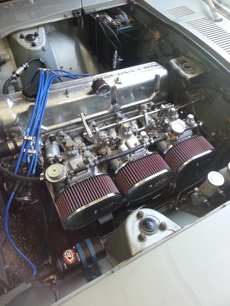

I just broke 1,000 miles on my new L29. I gave up on the triple SKs; they couldn't idle enough to my liking and I didn't want to mess with all the jets.
Sold them and made a couple hundred dollars. Back to my 3 screw SUs.
I cut my throttle arm from the firewall to the balance tube to use the SKs, so I had to find a new rod...difficult task. Stumbled on a local guy with a parts car, bought a bunch of carb parts, ended up with the whole dang car a couple weeks later in exchange for a 83 5 speed and p90 turbo head.
There was something wrong with the rebuilt kit I bought a couple years ago (maybe I got a flat top kit) that I put in because once everything was together, she wouldn't run. What do I do? Put in the original needle valves along with some SM needles...and she purrs like a kitten. Amazing throttle response, with stage III schneider, clifford headers, and borla muffler, everyone looks when I step on it. Sounds like a V8 at idle but the glorious straight six sound under load.
There's one catch. Once I hit 1,000 miles I started taking her over 4,000 rpms. At 5,000, she falls flat on her face and putters out. I'm going to dial in the timing this weekend with a timing light.
