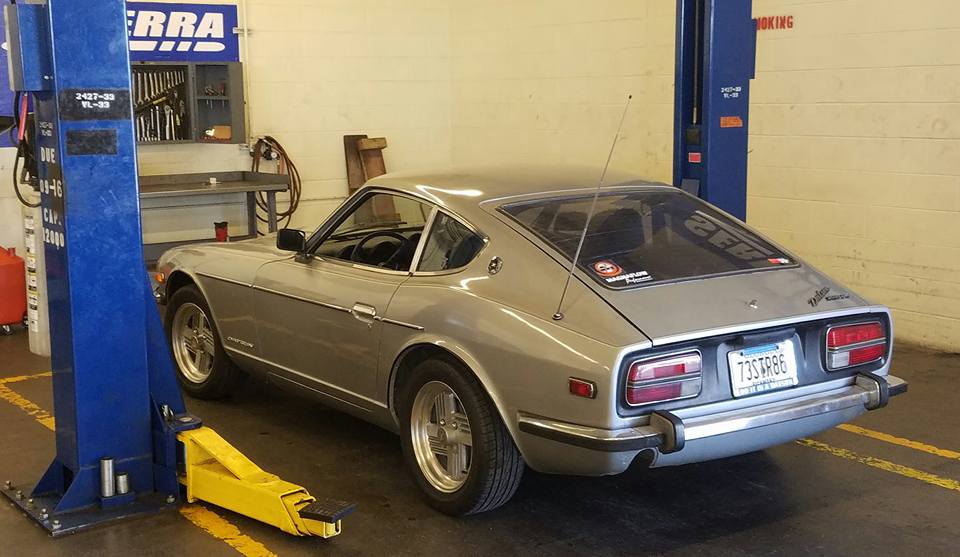

Long overdue update. The rear suspension renew and overhaul was a success. Everything was sandblasted and painted with VHT Roll Bar and Chassis paint. Tokico Illuminas and Vogtland springs (I wanted to give them a try). 4:11 open R180--I love it. The five speed is very nice as well...I need to stop forgetting that I have that 5th gear!

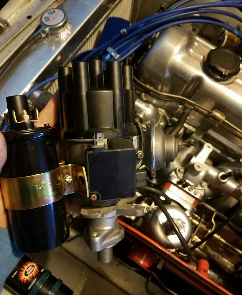

Funny story. As soon as the rear was buttoned up I went on three joy rides with 18 month old gas. All of a sudden, she wouldn't run. I suspect I got water in the distributor at the car wash. She was down for a few weeks. I went through 10 reman Cardone dizzies before I got a good one. I decided to upgrade to the 280zx distributor while I was replacing it anyway. 10!

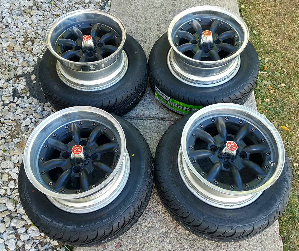

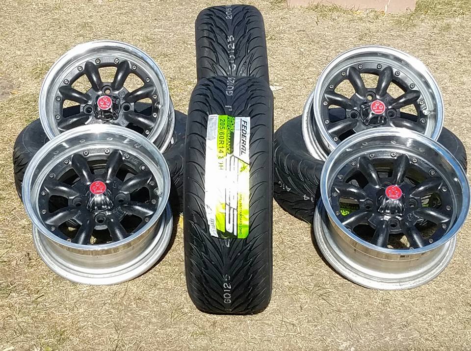

Now, I've logged another 40 miles or so. She's a blast. I refinished (amateur) a set of Watanabe RS-8s and these will most likely never come off of the car. She will be parked again for a clutch master cylinder (does anyone have a source for a larger bore?) and the clutch slave. Engagement is very weak, even after bleeding.

Looks really good, 10 dizzies? Did you just keep returning them until you found a good one? Tilton makes a clutch master that is slightly bigger and a direct bolt on but a new stock unit should do the job unless you have modified the tranny/clutch pack.
